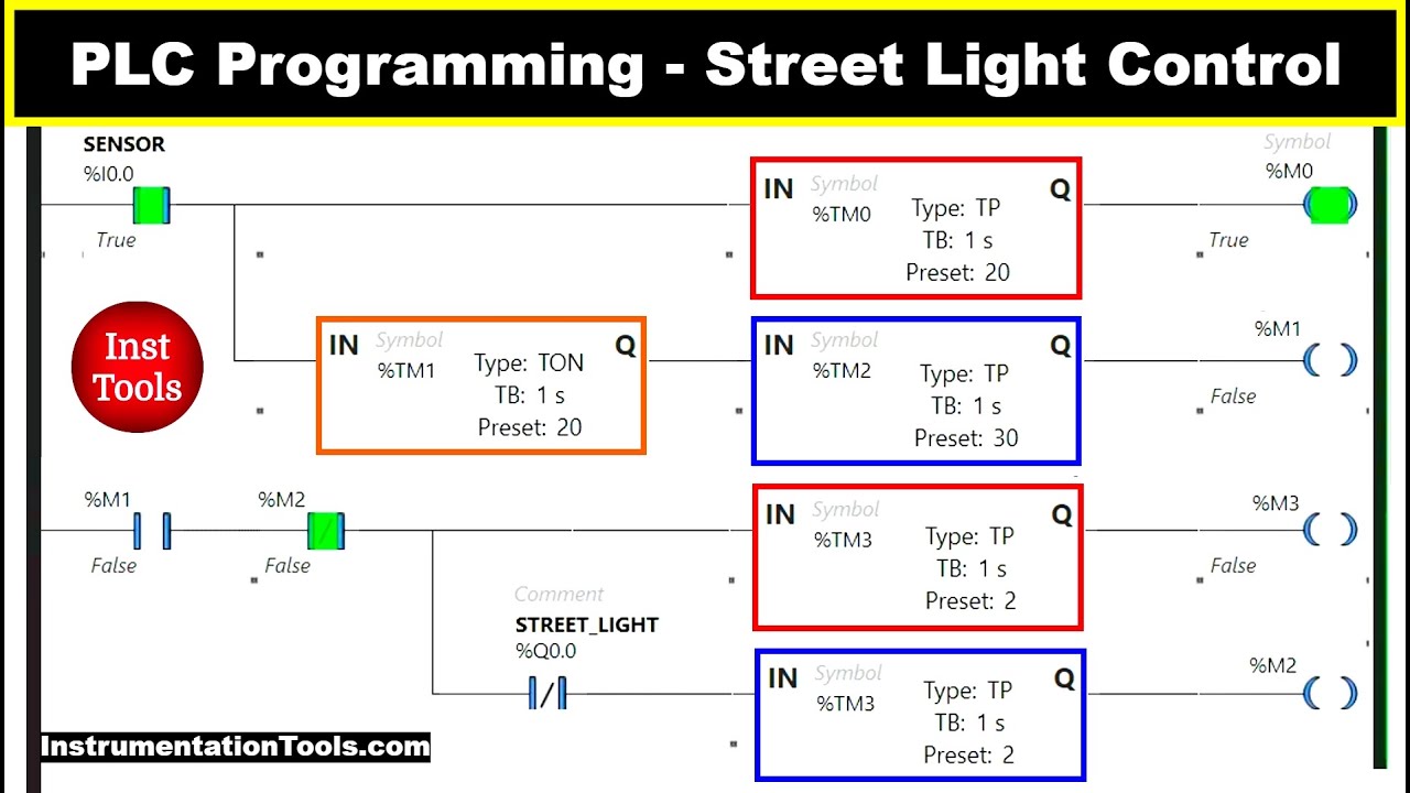

Programming Explanation
We have used Normally Open Contacts for Sensor (I0.0), Memory Bit 1 (M0), Memory Bit 2 (M1), and Memory Bit 4 (M3).
In Rung 0:
  1. Normally Open Contacts are used for Sensor (I0.0) to Turn ON  Memory Bit 1 (M0) and Memory Bit 2 (M1).
  2. Timer Function Block type TP is used to Turn ON Memory Bit 1 (M0) for a limited time.
  3. Timer Function Block type TON is used to delay the turning ON time of Memory Bit 2 (M1) for some time.
  4. Timer Function Block type TP is used to Turn ON Memory Bit 2 (M1) for a limited time.
In Rung 1:
  1. Normally Open Contacts are used for Memory Bit 2 (M1) to Turn ON  Memory Bit 4 (M3) and  Memory Bit 3 (M2).
  2. Normally Closed Contact is used for Memory Bit 3 (M2) to turn OFF Memory Bit 4 (M3).
  3. Timer Function Block type TP is used to Turn ON Memory Bit 4 (M3) for a limited time.
  4. Normally Closed Contact is used for Street Light (Q0.0) to turn ON Memory Bit 3 (M2).
  5. Timer Function Block type TON is used to delay the turning ON time of Memory Bit 3 (M2) for some time.
In Rung 2:
  1. Normally Open Contacts are used for Memory Bit 1 (M0) and Memory Bit 4 (M3) to turn ON the output Street Light (Q0.0).

When Sensor (I0.0) gets activated (Sensor detects movement), Memory Bit 1 (M0) turns ON as Normally Open Contact used for Sensor (I0.0) allows the signal to through it.
Motion Sensor based Street Lights Automation
When Memory Bit 1 (M0) turns ON in Rung0, Normally Open Contact used for Memory Bit 1 (M0) will be in True state and pass the signal to turn ON the output Street Light (Q0.0) or Street Light turns ON.
PLC motion detection street light
In Rung0, Memory Bit 1 (M0) will turn OFF after 20 seconds as Timer Function Block type TP is used to turn ON Memory Bit 1 (M0) for a limited time. The time is set to 20 seconds.
After 20 seconds, Memory Bit 1 (M0) turns OFF.
Automated street light control system
When Sensor (I0.0) gets activated (Sensor detects movement), Memory Bit 2 (M1) turns ON but after 20 seconds (i.e immediately after Memory Bit 1 (M0) turns OFF) as Timer Function Block type TON is used to delay the turning ON time of Memory Bit 2 (M1).
Sensor-controlled street lighting solution
The time is set to 20 seconds. After 20 seconds, Memory Bit 2 (M1) will turn ON but only for a limited time as Timer Function Block Type TP is used to turn ON Memory Bit 2 (M1) for a limited time.
Motion-sensing street light automation
When Memory Bit 2 (M1) turns ON in Rung0, Normally Open Contact used for Memory Bit 2 (M1) will be in True state and pass the signal through it.
In a false state, Memory Bit 3 (M2)  also passes the signal to turn ON Memory Bit 4 (M3).
Street light program with PLC
When Memory Bit 4 (M3) turns ON in Rung1, Normally Open Contact used for Memory Bit 4 (M3) will be in True state and the output Street Light (Q0.0) still remains ON.
Memory Bit 4 (M3) in Rung1 turns OFF after some time as Timer Function Block type TP is used to turn ON Memory Bit 4 (M3) for a limited time.
PLC logic for street light control
The time is set to 2 seconds. After 2 seconds, Memory Bit 4 (M3) turns OFF.
When Memory Bit 4 (M3) turns OFF in Rung1, Normally Open Contact used for Memory Bit 4 (M3) in Rung2 will be in a False state and the output street Light (Q0.0) turns OFF.
PLC programming for street light automation
When the output Street Light (Q0.0) turns OFF in Rung2, Normally Closed Contact used for Street Light in Rung0 will be in a False state and passes the signal to turn ON Memory Bit 3 (M2) and Memory Bit 3 (M2) turns ON but it will turn OFF within no time because in Rung1, Normally Closed Contact is used for Memory Bit 3 (M2).
Smart street light control with PLC
In Rung1, Normally Closed Contact used for Memory Bit 3 (M2) will also turn ON and OFF within no time and the whole process in Rung1 and Rung2 will restart and will run in a loop till the Timer Function Block type TP used for Memory Bit 2 (M1) in Rung0 will reach its time limit.
Street light control using motion sensor
The time is set to 30 seconds. After 30 seconds, Memory Bit 2 (M1) will turn OFF. When Memory Bit 2 (M1) turns OFF in Rung0, Normally Open Contact used for Memory Bit 2 (M1) will be in a False state and does not allow the signal to pass through it and the whole process stops.
