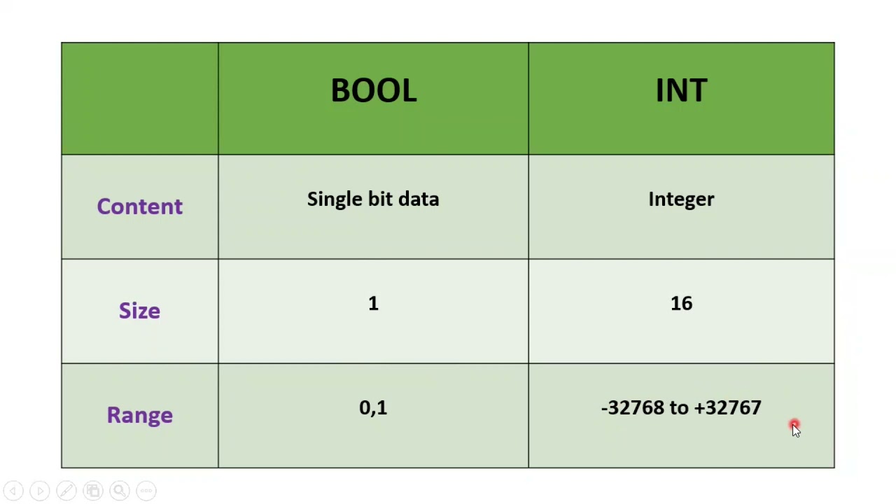

Bit
The format of a variable starts with a single bit. Its value is defined as 0 or 1.
In simpler terms, compare it with the Indian currency. It starts with a single paisa and multiple paisas make a rupee. Similarly, the format of any data type starts with a bit.
Its value is only true or false. The “bit” is also called as Boolean.

Any format with multiple bits can be classified into two types – signed and unsigned. Signed means the range has both positive and negative numbers.
Unsigned means the range has only positive numbers. So, here in a byte, an unsigned byte means 0 to 25; and a signed byte means -128 to 127.
 A byte is also called a short integer.
Integer
Now, 16 bits make an integer. The first start byte means LSB (least significant byte) and the last byte means MSB (most significant byte).
The value for 216 will be 65536. That means 65536 numbers of combinations or values will be possible in an integer.
An integer is also called as a word. But, a word cannot be signed. It will be unsigned only.
An unsigned integer means 0 to 65535, and a signed integer means -32768 to 32767.
