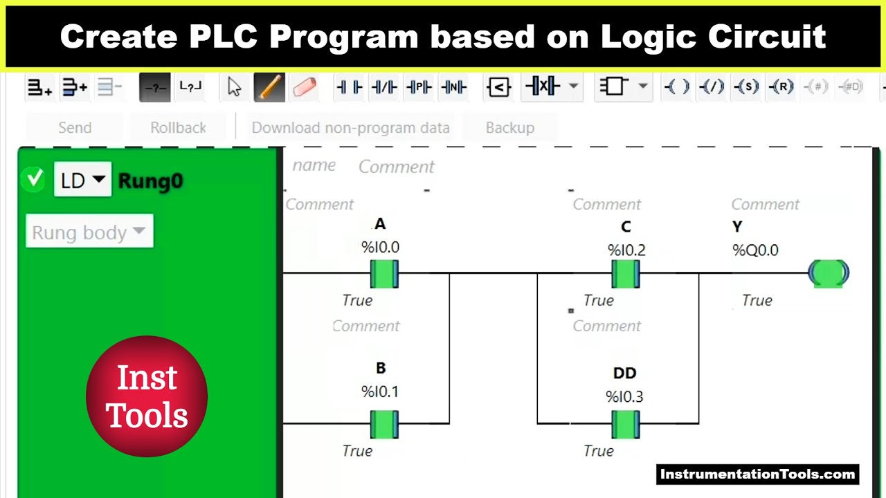

Problem Statement:
Design a PLC ladder logic for the following Logic Circuit.
We are using toggle Inputs to control the output.
Create PLC Program based on Logic Circuit
PLC Tutorial Video
Watch the video to understand the PLC concepts for a beginner level.
Inputs
The list of DI signals is listed below.
A: I0.0
B: I0.1
C: I0.2
D: I0.3
Outputs
The list of DO signals is listed below.
Y: Q0.0
Ladder Diagram
Boolean Algebra to PLC Logic
PLC Program Explanation
  • Here we used Schneider Electric PLC programming software. You can try any other PLC software too.
  • In this PLC program, Normally Open Contacts are used for input A, input B, input  C, and input D.
  • Input A and Input B are connected in parallel, thus implementing OR Logic Gate.
  • There is again the implementation of OR Logic Gate as Input C and Input D are connected in parallel.
  • AND Logic Gate is also implemented as  A + B is connected in series with C + D.
  • For the output Y (Q0.0) to be ON, Input A or Input B and Input C or Input D should be ON.
