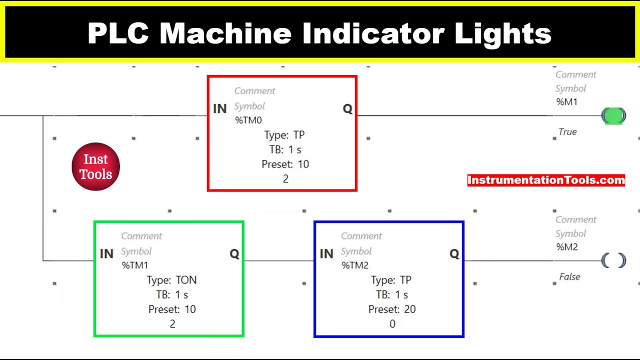

Problem Statement:
We are using one Push Button to control Machine 1, Machine 2, Red Light 1, Red Light 2, Green Light 1, and Green Light 2.
Suppose you have a warning Light system to indicate whether a Machine is running or not.
Two Red Lights will indicate individual Machine 1 and Machine 2 running status. These machines operate for 10 seconds and 20 seconds respectively.
Two Green Lights will indicate when machines are not operating.

We have used Normally Open Contacts for Start Button(I0.0) and Memory Bits.
In Rung 0:
  1. Normally Open Contact is used for the Start Button(I0.0) to Turn ON Memory Bit 1 (M0).
  2. Memory Bit 1 (M0) is latched so that when the Start Button(I0.0) turns OFF, Memory Bit 1 (M0) still remains ON.
In Rung 1:
  1. Normally Open Contact is used for Memory Bit 1 (M0) to Turn ON Memory Bit 2 (M1) and Memory Bit 3 (M2).
  2. Timer-type TP is used to Turn ON Memory Bit 2 (M1) for a limited time.
  3. Time-type TON is used to delay the turning ON time of Memory Bit 3 (M2) for some time.
  4. Timer-type TP is used to Turn ON Memory Bit 3 (M2) for a limited time.
In Rung 2:
  1. Normally Open Contact is used for Memory Bit 2 (M1) to Turn ON the outputs Machine 1 (Q0.0), Red Light 1 (Q0.2), and Green Light 2 (Q0.5).
In Rung 3:
  1. Normally Open Contact is used for Memory Bit 3 (M2) to Turn ON the outputs Machine 2 (Q0.1), Red Light 2 (Q0.3), and Green Light 1 (Q0.4).

When Memory Bit 1 (M0) turns ON in Rung0, Normally Open Contact used for Memory Bit 1 (M0) in Rung1 will be in True State and will pass the signal to turn ON Memory Bit 2 (M1) and Memory Bit 3 (M2).
PLC programming example of warning light system
When Memory Bit 2 (M1) turns ON in Rung1, Normally Open Contact used for Memory Bit 2 (M1) will be in True state and pass the signal to turn ON the outputs Machine 1 (Q0.0), Red Light 1 (Q0.2) {which indicates Machine 1 (Q0.0) is ON} and Green Light 2 (Q0.5) {which indicates Machine 2 (Q0.1) is OFF}.
How to interlock the lights using PLC ladder logic program
In Rung1, Memory Bit 2 (M1) turns OFF after some time as Timer Function Block type TP is used to turn ON Memory Bit 2 (M1) for a limited time.
The time is set to 10 seconds.
Warning Signal Ladder Logics
After 10 seconds, Memory Bit 2 (M1) turns OFF. When Memory Bit 2 (M1) turns OFF in Rung1.
Normally Open Contact used for Memory Bit 2 (M1) will be in a false state and does not allow the signal to pass through it and the outputs Machine 1 (Q0.0), Red Light 1 (Q0.2), and Green Light 2 (Q0.5) will turn OFF.
PLC based Project using indication lights
When Memory Bit 1 (M0) turns ON in Rung1, Memory Bit 3 (M2) will turn ON after 10 seconds (i.e immediately after Memory Bit 2 (M1) turns OFF) as Timer Function Block type TON is used to delay the turning ON time of Memory Bit 3 (M2).
Machine Monitoring and Indication Solutions
After 10 seconds, Memory Bit 3 (M2) will turn ON. When Memory Bit 3 (M2) turns ON in Rung1.
Normally Open Contact used for Memory Bit 3 (M2) will be in True state and pass the signal to turn ON the outputs Machine 2 (Q0.1), Red Light 2 (Q0.3) {which indicates Machine 2 (Q0.1) is ON} and Green Light 1 (Q0.4) {which indicates Machine 1 (Q0.0) is OFF}.
PLC Ladder program to turn on a light
In Rung1, Memory Bit 3 (M2) turns OFF after some time as Timer Function Block type TP is used to turn ON Memory Bit 3 (M2) for a limited time.
The time is set to 20 seconds. After 20 seconds, Memory Bit 3 (M2) turns OFF.
develop a PLC program for lighting control
When Memory Bit 3 (M2) turns OFF in Rung1, Normally Open Contact used for Memory Bit 3 (M2) will be in a false state and does not allow the signal to pass through it and the outputs Machine 2 (Q0.1), Red Light 2 (Q0.3) and Green Light 1 (Q0.4) will turn OFF.
