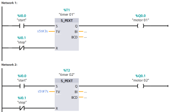

We can do that with timer but with a lot of level switches you will consume with every switch a separate timer from your plc, and that is really not professional way to deal with such a problem.
So here we can use a function that can make for us that delay and call it with every switch to allow a path for these switches through the same function to make your desired process (delay).
Example Function Program: Click Here
Example Call Program: Click Here
In the above example, the function logic is named “ONDLY-TMR” which is a timer program that provides some time delay wherever we use it.
In call program, we have different networks for level switches and motors. We call the function “ONDLY-TMR” in each network to provide the required time delay.
Note that for this situation you do not need any variable data to be stored, it’s just a delay that can be made easily without the need for static memory so here we can use FC.
