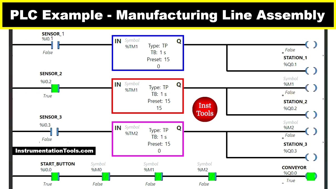

We are using one toggle switch and three sensors to control 3 stations.
The product should move through 3 assembly stations, with each station operating for 15 seconds.

PLC Program Inputs
The PLC program inputs are shown below.
Start Button: I0.0
Sensor 1: I0.1
Sensor 2: I0.2
Sensor 3: I0.3
PLC Program Outputs
The PLC program outputs are shown below.
Station  1: Q0.0
Station 2: Q0.1
Station 3: Q0.2

We have used Normally Open Contacts for Start Button(I0.0), Sensor 1 (I0.1), Sensor 2 (I0.2), and Sensor 3 (Q0.3).
In Rung0:
1) Normally Open Contact is used for Sensor 1 (I0.1) to Turn ON  Memory Bit 1 (M0) and the output station 1 (Q0.1).
2) Timer Function Block type TP is used to Turn ON Memory Bit 1 (M0) and the output station 1 (Q0.1) for a limited time.
In Rung1:
1) Normally Open Contact is used for Sensor 2 (I0.2) to Turn ON  Memory Bit 2 (M1) and the output station 2 (Q0.2).
2) Timer Function Block type TP is used to Turn ON Memory Bit 2 (M1) and the output station 2 (Q0.2) for a limited time.
In Rung2:
1) Normally Open Contact is used for Sensor 3 (I0.3) to Turn ON  Memory Bit 3 (M2) and the output station 3 (Q0.3).
2) Timer Function Block type TP is used to Turn ON Memory Bit 3 (M2) and the output station 3 (Q0.3) for a limited time.
In Rung3:
1) Normally Open Contact is used for the Start Button (I0.0) to Turn ON  the output Conveyor (Q0.0).
2) Normally Closed Contacts are used for Memory Bit 1 (M0), Memory Bit 2 (M1), and Memory Bit 3 (M2) to Turn ON  the output Conveyor (Q0.0).

When the Start Button (I0.0) is turned ON in Rung3, the output Conveyor (Q0.0) turns ON ( Conveyor starts moving) as Normally Open Contact used for start Button (I0.0) will be in True state and passes the signal to turn ON the output Conveyor (Q0.0).
In the False state, Normally Closed Contacts used Memory Bit 1 (M0), Memory Bit 2 (M1), and Memory Bit 3 (M2) in Rung3 will also pass the signal to turn ON the output Conveyor (Q0.0) and the output Conveyor (Q0.0) turns ON (Conveyor starts moving).
When Sensor 1 (I0.1) gets activated in Rung0 ( Product reaches Station 1), Memory Bit 1 (M0) turns ON, and also, the output Station 1 (Q0.1) turns ON (Machines at Station 1 starts working).
When Memory Bit 1 (M0) turns ON in Rung0, Normally Closed Contact used for Memory Bit 1 (M0) in Rung3 will be in a True state and does not allow the signal to pass through it and the Conveyor (Q0.0) turns OFF ( Conveyor stops at Station 1 ).
In Rung0, Memory Bit 1 (M0) and the output Station 1 (Q0.1) turn off after some time as  Timer Function Block type TP is used to Turn ON the output Station 1 (Q0.1) and Memory Bit 1 (M0) for a limited time. The time is set to 15 seconds.
After 15 s, the output Station 1 (Q0.1) and Memory Bit 1 (M0) will turn OFF (Machines at Station 1 finished their work).
When Memory Bit 1 (M0) turns OFF in Rung0, Normally Closed Contact used for Memory Bit 1 (M0) will be in a False state and allow the signal to pass through it and the output Conveyor (Q0.0) turns ON (Conveyor starts moving).
