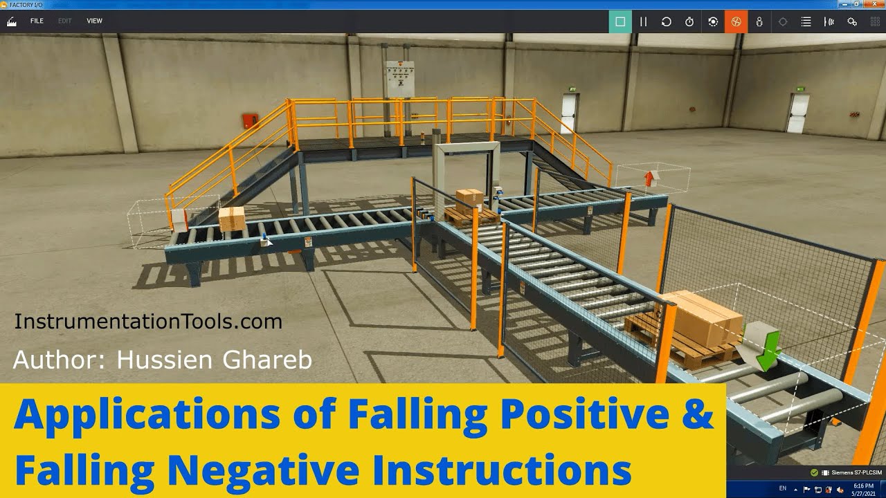

Application for Using FP & FN Instructions
In the below video, we explained the basic example and application usage of falling positive and falling negative instructions using a conveyor simulation.
