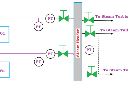

Steam Flow
  • Measurement of Inlet steam flow is done with an orifice head installed in the steam line.
  • The differential head produced is measured using Differential Pressure Transmitter and square rooted to obtain linearized flow reading.
  • The steam flow is also integrated for accounting and analysis purposes.
  • Knowing the total steam consumed by a turbine for a specific period and the power generated for the same period, to analyze the performance of a steam turbine.
  • Steam consumed per MW of power produced is called specific steam consumption.
  • Turbine performance may be rated according to this factor among different turbines in the power plant.

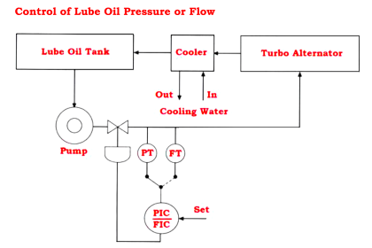

Lube Oil Parameters
  • Lubrication oil is used to cool the turbine bearings and alternator bearings.
  • Various process parameters such as flow, level, pressure, & temperature are measured in connection with lube oil
  • Pressure measurement is carried out with the help of a pressure transmitter for remote indication and with a Bourdon tube pressure gauge for local indication.
  • Flow measurement is done with an orifice along with a DP transmitter or rotameter.
  • In the case of rotameter along with DP transmitter, the purpose serves for both local and remote indication.
  • Temperature measurement is carried out with RTD as a sensor and a transmitter for remote indication and control.
  • Mercury in glass thermometers or gas-filled thermometers is used for local indication purposes.
  • DP transmitter serves for remote transmission, and gauge glass serves for the local indication for measurement of Lubrication oil tank level
  • Annunciation contacts are generated with the help of remote indicators and/or local indicators.
