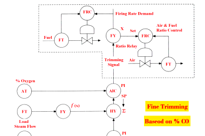

Feed Forward + Feedback Steam Pressure Control
  • The net main steam flow from the boiler is used as a feed-forward signal to get a faster reply from the master controller for firing rate demand for the individual boilers.
  • Practically, it is not possible to measure the main steam flow inlet or outlet from the steam header by the individual flow meter.
  • The generated main steam from individual boilers or the steam consumed by individual steam turbines is mixed together.
  • An arrangement of feed forward-plus-feedback master control is shown in Figure below.
  • In this arrangement, the total net main steam flow from all boilers is considered as feed-forward demand.
  • The proportional multiplier function is adjusted at the input side of summer such that a change in the main steam flow produces an accurate steady-state change in firing rate demand.
  • The steam pressure controller provides the correct adjustment of the firing rate demand for over-firing or under-firing to adjust energy input.
  • In the normal power plant installation, variation in steam header pressure is due to the change in steam flow rate demand at the receiver side of the steam header.
  • If there is a high-pressure drop between the boiler and steam header, then the change in steam flow rate causes a large change in steam header pressure due to changes in supply-side pressure drop.
  • These pressure changes define different things in the system.
  • The change in steam pressure demand at the receiver side symbols for change in firing rate should be changed because the user requires maximum steam.
  • A change in steam pressure drop on the supply side indicates a change in the firing rate to change the stored energy represented by boiler pressure is required.
