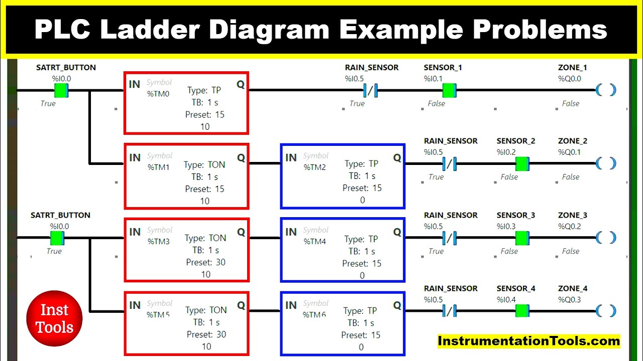

There is a garden water sprinkler system with 4 zones. Zone 1 should operate for 15 seconds, then Zone 2 should operate for 15 seconds, then Zone 3 should operate for 15 seconds, then Zone 4 should operate for 15 seconds.
The system will operate only if it is not raining and there is no one in that particular zone.

We have used Normally Open Contact for the Start Button (I0.0).
In Rung 0:
  1. Normally Open Contact is used for the Start Button (I0.0) to Turn ON the outputs Zone 1 (Q0.0) and Zone 2 (Q0.1).
  2. Timer Function Block type TP is used to Turn ON the output Zone 1 (Q0.0) for a limited time.
  3. Timer Function Block type TON is used to delay the turning ON time of the output Zone 2 (Q0.1) for some time.
  4. Timer Function Block type TP is used to Turn ON the output Zone 2 (Q0.1) for a limited time.
  5. Normally Closed Contacts are used for Rain Sensors (I0.5) to turn OFF the outputs of Zone 1 (Q0.0) and Zone 2 (Q0.1).
  6. Normally Closed Contact is used for Sensor 1 (I0.1) to turn OFF the output Zone 1 (Q0.0).
  7. Normally Closed Contact is used for Sensor 2 (I0.2) to turn OFF the output Zone 2 (Q0.1).
In Rung 1:
  1. Normally Open Contact is used for the Start Button (I0.0) to Turn ON the outputs Zone 3 (Q0.2) and Zone 4 (Q0.3).
  2. Timer Function Block type TON is used to delay the turning ON time of the output Zone 3 (Q0.2) for some time.
  3. Timer Function Block type TP is used to Turn ON the output Zone 3 (Q0.2) for a limited time.
  4. Timer Function Block type TON is used to delay the turning ON time of the output Zone 4 (Q0.3) for some time.
  5. Timer Function Block type TP is used to Turn ON the output Zone 4 (Q0.3) for a limited time.
  6. Normally Closed Contacts are used for Rain Sensors (I0.5) to turn OFF the outputs of Zone 3 (Q0.2) and Zone 4 (Q0.3).
  7. Normally Closed Contact is used for Sensor 3 (I0.3) to turn OFF the output Zone 3 (Q0.2).
  8. Normally Closed Contact is used for Sensor 4 (I0.4) to turn OFF the output Zone 4 (Q0.3).
Program Simulation
We will simulate the PLC program and discuss the results. We may show the partial logic instead of the complete program in the below test cases. Watch the above video to learn this programming.
Rung 0:
When the Start Button (I0.0) is turned ON, the output Zone 1 (Q0.0) turns ON (Garden sprinkler system starts in Zone 1) but for a limited time as Timer Function type TP is used to turn ON the Output Zone 1 (Q0.0) or Start the Garden Sprinkle system in Zone 1 for a limited time. The time is set to 15 seconds.
Automated garden sprinkler logic
So after 15 seconds, the output Zone 1 (Q0.0) will turn OFF, or after 15 seconds Garden sprinkler system in Zone 1 stops.
Also, when Start Button (I0.0) is turned ON, the output Zone 2 (Q0.1) will turn ON after 15 seconds, or the Garden sprinkler system will start in Zone 2 after 15 seconds i.e immediately after the output Zone 1 (Q0.0) is turned OFF or (after Garden sprinkler system in Zone 1 stops) because Timer Function Block TON is used to delay the turning ON time of the output Zone 2 (Q0.1). The time is set to 15 seconds.
PLC control for zone-based watering
After 15 seconds, the output Zone 2 (Q0.1) will turn ON, or after 15 seconds Garden sprinkler system starts in Zone 2 but for a limited time as Timer Function Block type TP is used to turn ON the output Zone 2 (Q0.1) for a limited time. The time is set to 15 seconds.
Sprinkler system automation
After 15 seconds, the output Zone 2 (Q0.1) turns OFF, or after 15 seconds the Garden sprinkler system in Zone 1 stops.
If Rain sensor (I0.5) gets activated in Rung0 (Rain starts), the outputs in Rung0 Zone 1 (Q0.0) and Zone 2 (Q0.1) will remain OFF or will turn OFF (Garden sprinkler system in Zone 1 and Zone 2 will not start or will turn OFF if it was started).
Garden irrigation with PLC
If Sensor 1 gets activated in Rung0 (Sensor detects movement in Zone 1), the output Zone 1 (Q0.0) will remain OFF or will turn OFF (Garden sprinkler system in Zone 1 will not start or will turn OFF if it was started).
Rain sensor based PLC program for water
If Sensor 2 gets activated in Rung0 (Sensor detects movement in Zone 2), the output Zone 2 (Q0.1) will remain OFF or will turn OFF (Garden sprinkler system in Zone 2 will not start or will turn OFF if it was started).
Sprinkler timer control with PLC Programming
Rung 1:
When the Start Button (I0.0) is turned ON, the output Zone 3 (Q0.2) turns ON after 30 seconds, or after 30 seconds the Garden sprinkler system starts in Zone 3 i.e immediately after the output Zone 2 (Q0.1) is turned OFF or (after Garden sprinkler system in Zone 2 stops) because Timer Function Block TON is used to delay the turning ON time of the output Zone 3 (Q0.2). The time is set to 30 seconds.
Rain detection in garden sprinklers
After 30 seconds, the output Zone 3 (Q0.2) will turn ON, or after 30 seconds Garden sprinkler system in Zone 3 starts but for a limited time as Timer Function Block type TP is used to turn ON the output Zone 3 (Q0.2) for limited time. The time is set to 15 seconds.
PLC logic for garden watering
After 15 seconds, the output Zone 3 (Q0.2) turns OFF, or after 15 seconds Garden sprinkler system in Zone 3 stops.
Also, when Start Button (I0.0) is turned ON, the output Zone 4 (Q0.3) will turn ON after 45 seconds, or the Garden sprinkler system will start in Zone 4 after 45 seconds i.e immediately after the output Zone 3 (Q0.2) is turned OFF or (after Garden sprinkler system in Zone 3 stops) because Timer Function Block TON is used to delay the turning ON time of the output Zone 4 (Q0.3). The time is set to 45 seconds.
Garden sprinkler automation solution
After 45 seconds, the output Zone 4 (Q0.3) will turn ON, or after 45 seconds Garden sprinkler system starts in Zone 4 but for a limited time as Timer Function Block type TP is used to turn ON the output Zone 4 (Q0.3) for a limited time. The time is set to 15 seconds.
Smart garden watering using PLC program
After 15 seconds, the output Zone 4 (Q0.3) turns OFF, or after 15 seconds Garden sprinkler system in Zone 4 stops.
If Rain sensor (I0.5) gets activated in Rung1 (Rain starts), the outputs in Rung1 Zone 3 (Q0.2) and Zone 4 (Q0.3) will remain OFF or will turn OFF (Garden sprinkler system in Zone 3 and Zone 4 will not start or will turn OFF if it was started).
Garden sprinkler timer programming
If Sensor 3 gets activated in Rung1 (Sensor detects movement in Zone 3), the output Zone 3 (Q0.2) will remain OFF or will turn OFF (Garden sprinkler system in Zone 3 will not start or will turn OFF if it was started).
Ladder Logic for Water Sprinkler
If Sensor 4 gets activated in Rung1 (Sensor detects movement in Zone 4), the output Zone 4 (Q0.3) will remain OFF or will turn OFF (Garden sprinkler system in Zone 4 will not start or will turn OFF if it was started).
