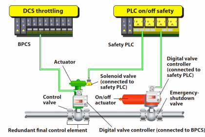

Logic Solver in Safety PLC
Image Courtesy: Emerson

Independence
SIS Logic solver Software for safety functions to be made independent and separated from software for basic process control (BPCS).
The SIS code must be clearly identified in the program. Typically, in industry, the SIS is physically separated from the BPCS by the use of independent logic solvers.
