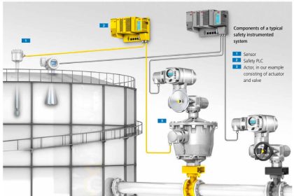

Like all automatic control systems, an SIS consists of three basic sections:
  1. Sensor(s) to detect a dangerous condition,
  2. Controller to decide when to shut down the process, and
  3. Final control element(s) to actually perform the shutdown action necessary to bring the process to a safe condition.
Sensors may consist of process switches and/or transmitters separate from the regulatory control system.
Controller for an SIS is usually called a logic solver, and is also separate from the regular control system.
Final control elements for an SIS may be special on/off valves (often called “chopper” valves) or override solenoids used to force the normal control valve into a shutdown state.
