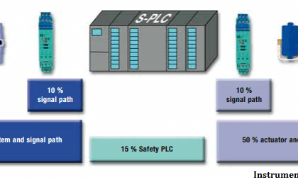

SIS Bypass and Impairment - Safety Instrumented System
Image Courtesy: Moore Industries
