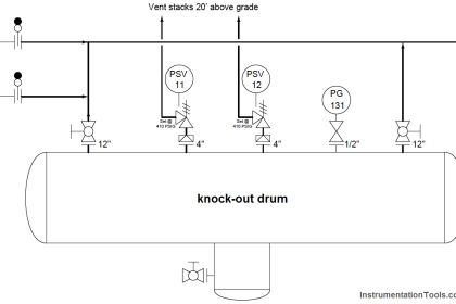

Process designers use a variety of protection layers, or safeguards, to provide a defense in depth against catastrophic accidents. They are devices, systems or actions that are capable of preventing a scenario from proceeding to an undesired consequence.
For example, they may be:
- Inherently safe design features
- Physical protection such as relief devices
- Post-release physical protection such as fire suppression systems
- Plant and community emergency response
- Safety Instrumented Systems (SIS)
Ideally such protection layers should be independent from one another so that any one will perform its function regardless of the action or failure of any other protection layer or the initiating event. When they meet this criterion they are called Independent Protection Layers (IPL).
Not all safeguards meet the independence requirements to be classified as an IPL, although all IPLs are safeguards. For example, two standby pumps that are both electrically powered do not fail independently in the event of loss of power.
