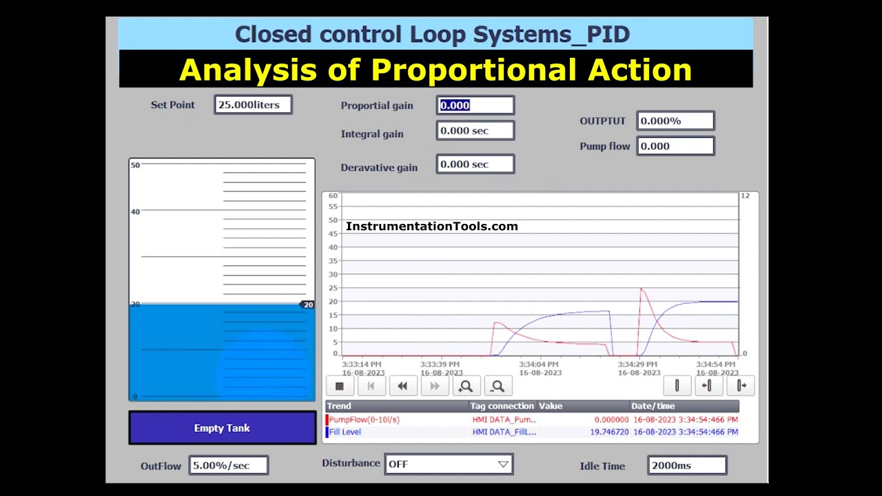

Simulate Proportional Controller - PID in PLC Systems
As you can see, at the start, the set point was set to 25 liters, and the P gain was set to 1, you can see the controller output starts at 25% which corresponds to 2.5 liters/sec for the pump. And then the output starts to go down as the tank is being filled and the error is getting lower.
In the simulation video, we simulated three different values to the P gain.
  • First, the P gain was set to 1 and the pump started at 2.5liters/sec, then the flow started to go down as the error decreases.
  • Secondly, the P gain was set to 2 and the pump started at 50% of the full power which is 5 liters/sec, then again started to go down as the error decreases.
  • Finally, we set the P gain to 4, and the pump started at 100%of the full power which is 10 liters/sec, then again started to go down as the error decreases.
As you can see the controller output is proportional to the error value, hence the name proportional or P. That means as the tank starts to be filled with water and the level increases the error will decrease because the level is now closer to the set point.
As the error decreases the proportional gain of the controller will also decrease. And that is why reaching the set point with only a proportional gain is not always achievable, because as the error approaches zero so will the controller output. And that is why you will have a small error that cannot be regulated with the P gain alone. This is also called the steady-state error. See picture 1.
PID Controller Steady State Error
Picture 1. Steady-state error with P gain

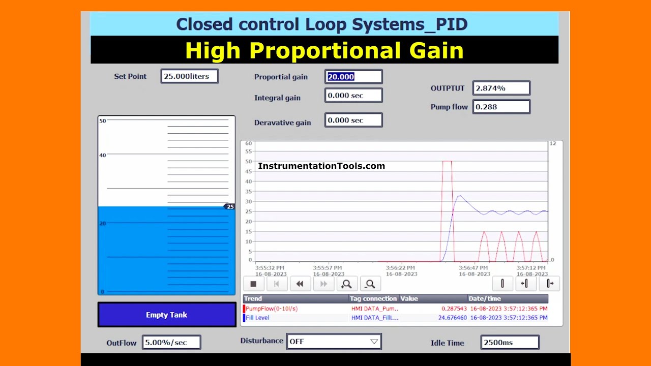

See the next video where we increase the P gain very much.
Effect of High Proportional Gain - PID Controller Simulation in PLC Program
As you can see, the level never reaches the set point. Even when I increase the gain to a very high value, it will go over our set point and it will start to oscillate, see picture 2.
PID Controllers in Closed Loop Control Systems
picture 2. Oscillation with high P gain.
Oscillations are not something you want in a control system. And that is where the integral part of the PID controller comes in handy.

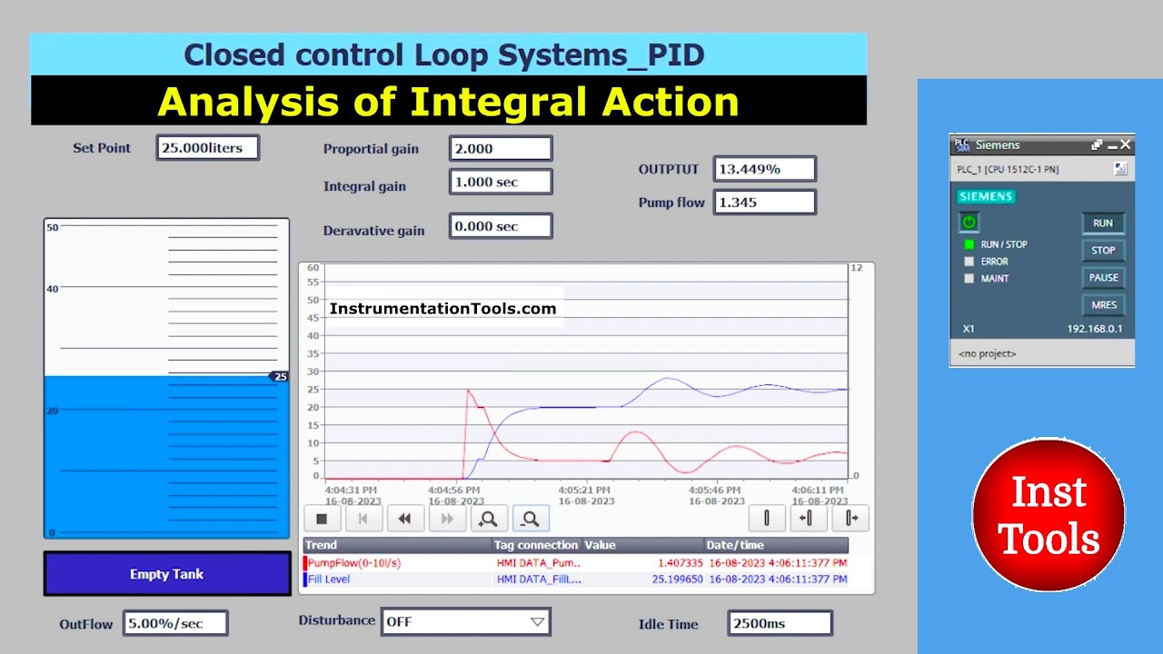

Analysis of Integral Controller with Simulation - PID Tutorials
as you can see, we started with a P gain of 2, the level saturated at below set point, but when we used an integral part of the PID, the level started to increase.
At the beginning, there was an overshoot but after a while, the level stabilized at the required set point. And that is why the integral part is a very critical part of the PID.
You should know that if you want to improve the system response. To reduce the time needed to reach the set point or to reduce the overshot, more attention will be made to tuning the parameters.
You should also know that the compact PID block in Siemens PLCs which we are using in our simulation, works in such a way that it has to have a proportional gain, if the P gain is zero, the PID will not have any effect even if the I and D parameters have values. That is why we couldn’t simulate the behavior of the system with only the I part as you saw in the previous video.

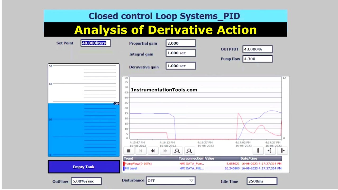

Derivative Controller Action - PID Controller Simulation
As you can see, when the set point changes suddenly leading to the error changing also suddenly the controller action was aggressive due to the use of the derivative part. See picture 3.
Basics of PID Controllers
picture 3. The aggressive action of the Derivative controller.
