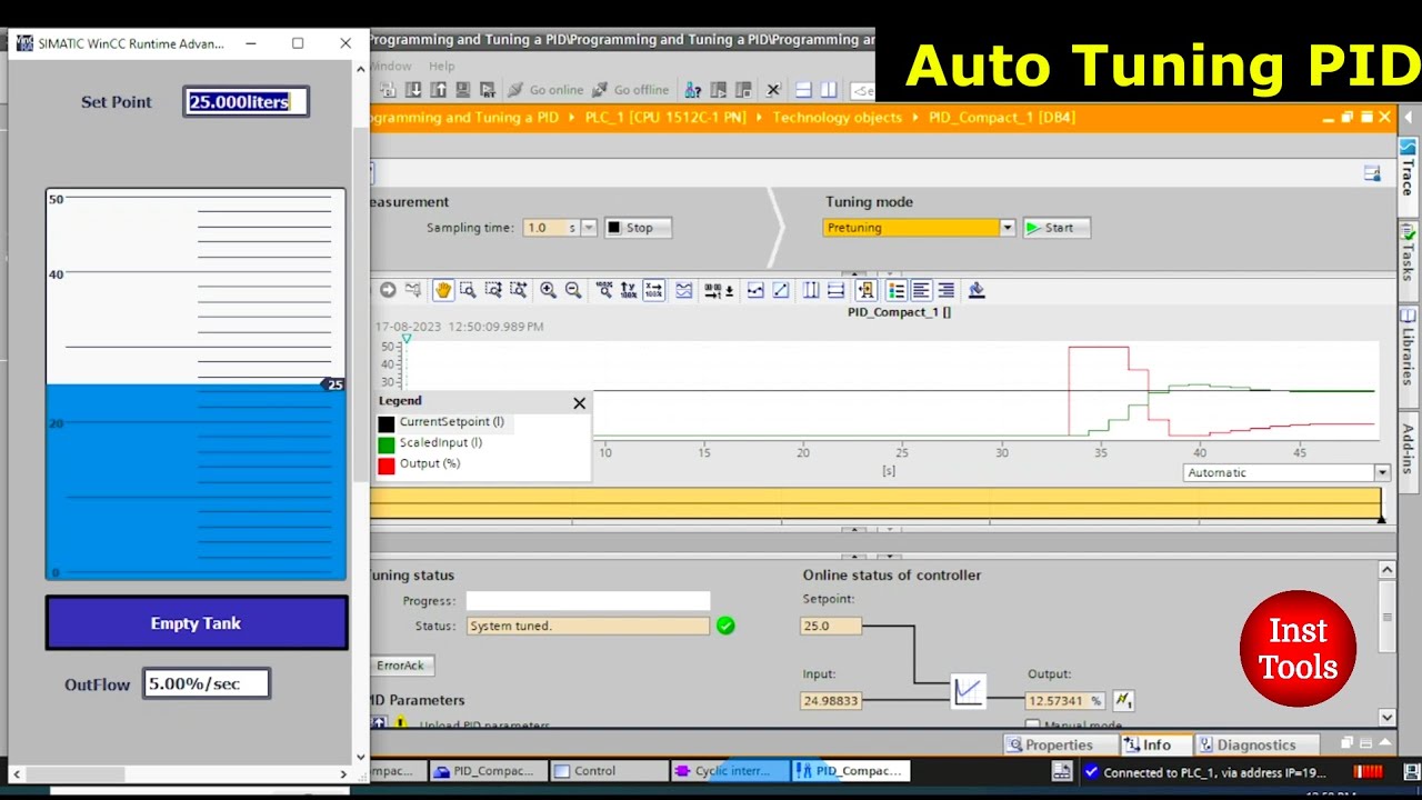

How to perform tuning of the PID
Picture 12. PID parameters.
Here you can write the tuning parameters for your PID gains P, I, and D in case you know them or in case you made the tuning yourself and you have the parameters from elsewhere.   You can also choose to decide to use a PID or just a PI controller.
If you don’t have these parameters, you can upload them automatically after you make tuning to your PID.
How to Perform Tuning of the PID?
Now that you finished your PID configuration, you can tune your controller just as easily from the commissioning tab in the project tree. See picture 13.
Commissioning PID Controller
Picture 13. Commissioning your PID
On the commissioning page, you have your screen divided into 3 parts, the upper page is where you can start pre-tuning and fine-tuning the PID.
In the middle, you will have a graph area to show you the real-time response of your system. You can see the controller output and the process value. And each time the set point changes, you will see the behavior of your PID to catch this new set point. Even if the set point didn’t change but for example the demand from our tank supply is increased, you will see the PID reaction to supply that demand and also keep the set point at its required value.
In the third area, you will have the online status of your controller and you can also decide the operating mode of your PID. See the following simulation video showing the auto-tuning procedure of the PID in the TIA Portal.
Auto Tuning PID Controller Simulation - Basics of PLC
From the video, you can see that after pre-tuning is done, our PID found the P, I, and D parameters to best suit our system. You can see that when the set point or the outflow changes the controller will react very quickly to bring the set point back to the required values.
You can now upload your tuning parameters directly into your project with a simple button click, see picture 14.
PLC PID tuning parameters
Picture 14. Upload your parameters.
Once you have uploaded your parameters, you can find them in the PID parameters tab in the configuration view. See picture 15.
PID Controller in Siemens Tia Portal Tutorial
Picture 15. PID parameters.
The next step should be to perform a fine-tuning procedure to the PID from the same commissioning view, however, because we don’t have a real system and we are just simulating the behavior of the tank and pump using mathematical calculations we can’t do the fine-tuning step.
When you have a real system you can make the fine-tuning where your PID will try to find the parameters that will give the system a better response and even eliminate the overshoot of your process value and directly reach the set point.
