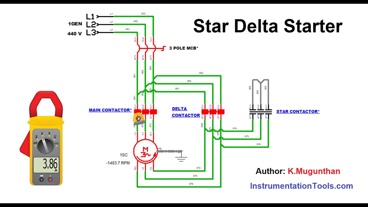

Circuit Diagram of Star Delta Starter
The star delta starter circuit consists of two parts.
They are
  1. Power Circuit
  2. Control Circuit
Power Circuit
Star Delta Starter Power Circuit Diagram
Control Circuit
Star Delta Starter Control Circuit

The main contactor is being energized because of the latch and also Star contactor is energized by the closed contacts of the Timer and delta contactor.
Components of Star Delta Starter
Now the motor is Working on Star mode.
Star Delta Starter Working Principle
At the same time, the timer starts counting the time which was set on it after the actual time gets equal to the preset time.
The auxiliary contact gets changed which cuts the star connection makes the motor to run on Delta mode.
Star Delta Motor Starter Circuit
The Main Contactor stage will be the same as earlier only.
Now the motor runs with Delta and Main Contactor which means the motor starts to rotate with its full power.

  1. Hi there.
    I think you must correct the connection of the power circuit. When delta contactor is energised, the V2 pole of the motor doesn’t connect with the W1 pole, as it should, but with the U1 as shown now in the schematic….
    Thank you and keep on the good work!
