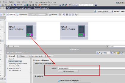

Configure Profinet in Siemens PLC
Now let’s learn how to configure an IP address for device in Siemens TIA PORTAL.
Step 1:
Open TIA PORTAL. Click on “project view”.
Open TIA PORTAL and Click on project view
Step 2:
The following window will pop up. Expand “online access”.
online access in Tia portal
Step 3:
In online access, you can find an option written “intel”, expand it. Double click on “update accessible devices”. After a few seconds “accessible devices” will appear.
accessible devices in Tia portal
Step 4:
Clicking on accessible devices will open up the following window. Here Expand “function”.
Click on IP address to assign an IP address. Click on “Assign IP address” to finish the procedure.
What is Profinet and How to Configure in Siemens PLC
Step 5:
In the “properties” window you can find the message of successful completion of assigning IP addresses.
assigning IP addresses in tia portal
