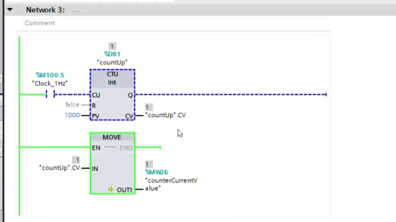

Move block is Not Edge Triggered
When using a Move you should know that a move block is not edge triggered, which means as long as the enable input “EN” has the signal state 1 the move instruction will be executed.
So if you need to only move the value one time at a certain event you need to make sure the EN is only triggered at that event.
The following video shows that concept.
Move block is Not Edge Triggered - PLC Programming Tips
As you see from the video, as long as the enable signal is 1 the IN will constantly be moved to OUT1.
That is not a mistake in itself, you just need to pay attention if whether is the logic you’re aiming for or not. Because if you need to move the information one time only you need to set a trigger for only that needed event.
