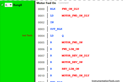

Ladder Logic vs. Instruction List
Instruction List is a language in which the logic is written in text format, but similar to assembly-type languages. The logic flow is the same as written in ladder logic, but the style of writing is different. Instruction List (IL) language directly uses assembly language texts, like AND, ANDN, LDN, etc. The language is a mix of ladder logic and structured text. This means the way we write the logic in NO and NC format in either series or parallel way; the same is denoted in assembly text format way.
Refer to the below figure for an example. Let us interpret the first rung written in ladder logic with that written in IL. If %M0 is off, and %M1 is on and %M2 is off, then the 2 value will be moved to %MW0. This interpretation is written in IL as shown in the figure. The meaning is the same, only the way of conveying is different.
Usually, it is the least used language, due to it’s complex writing methods and interpretations. So, the preferred language is ladder logic in this case.
