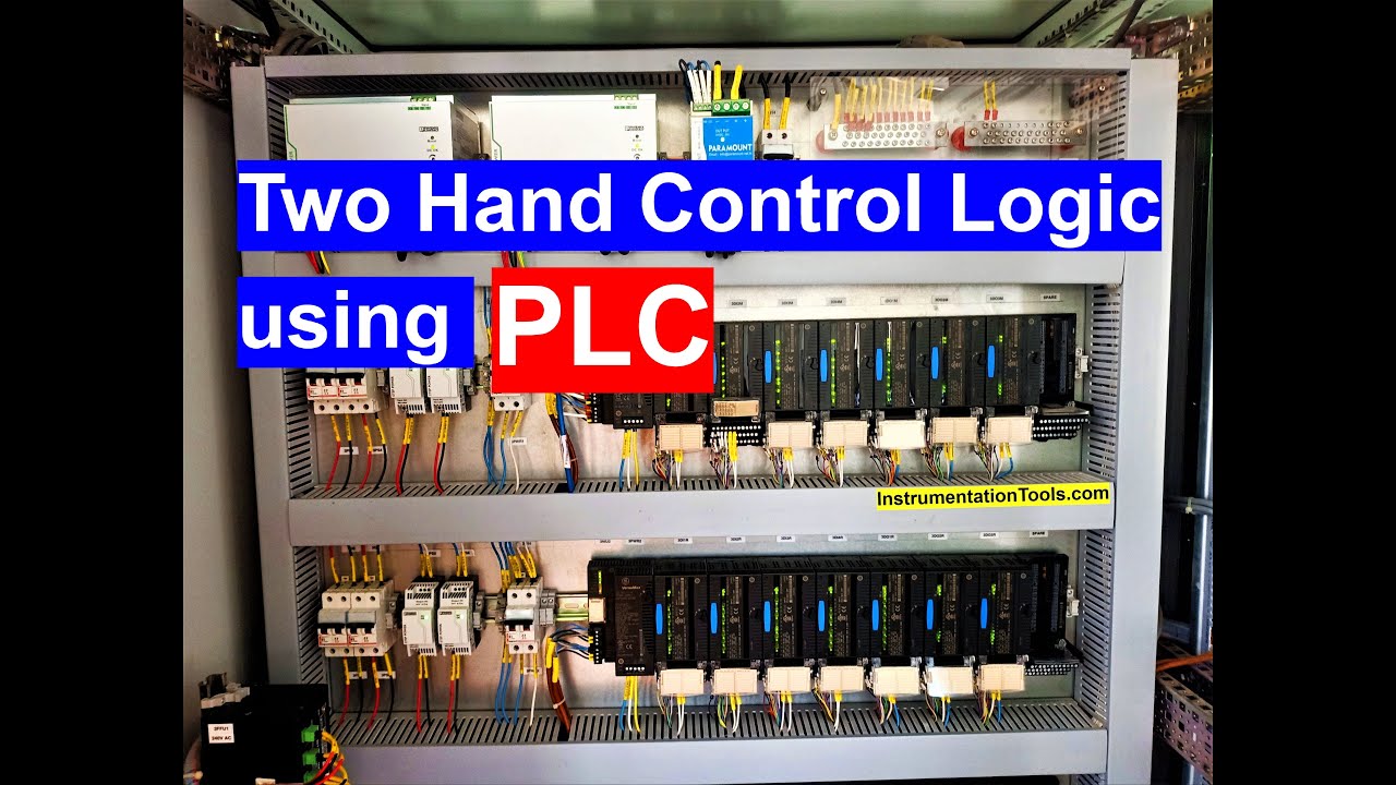

In order to provide a high level of safety for a worker of a cutting machine a two-hand press safety control circuit is used to ensure the worker’s hands are out of danger while the machine is running.
The operator of the machine must press the two pushbuttons with both hands for the machine to start running, and it will only keep running as long as he is pressing the push buttons, any time he releases one or both hands, the machine will stop immediately.

As you can see from the picture, the motor will not start unless there is no emergency active and the safety door is closed and unless the TwoHandPress_Output is set to true, which will not happen unless the two push buttons are pressed at the same or within 500ms.
