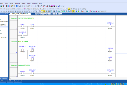

  • Here and after selecting the PLC you have to go online with your code to see what is going into your logic visually, that would really help a lot to track the problem.
PLC go online with your code
  • Now we are online with our PLC to know why the process is not running even we are pressing on the start push button.
  • As we can see it is too easy to trace the activated and deactivated bits from the ladder logic, the green bit is activated and the blue dashed one is not activated.
Siemens PLC Ladder Diagram Code
Ladder Logic Online
  • After going to the Emergency stop at the site and activate it, now we can see all of the branch is correctly operated.
Emergency stop plc programming
