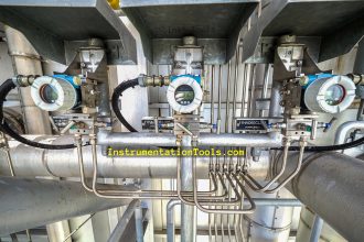

A Centrifugal Compressor with a single stage was installed in one of the plants in a refinery. This centrifugal Compressor was a kind of booster Compressor.
The inlet to the Compressor was 5 kg/cm2 and the outlet of the Compressor was 9 kg/cm2. While the Compressor was running, the Panel Engineer observed that the Compressor’s Suction Pressure Low alarm was generated for all 3-pressure transmitters.
Within a few seconds, Compressor’s Suction Pressure Low Low alarm was also generated for all 3 Suction Pressure Transmitters. Immediately the Panel Engineer pressed the emergency shutdown button and stopped the Compressor.
