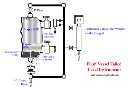

  6. Extending this idea, displacer chambers steam PBVs welded bonnet downwards (fig 3) are leak free. Benefits 1a-1e apply to Level transmitters too.
