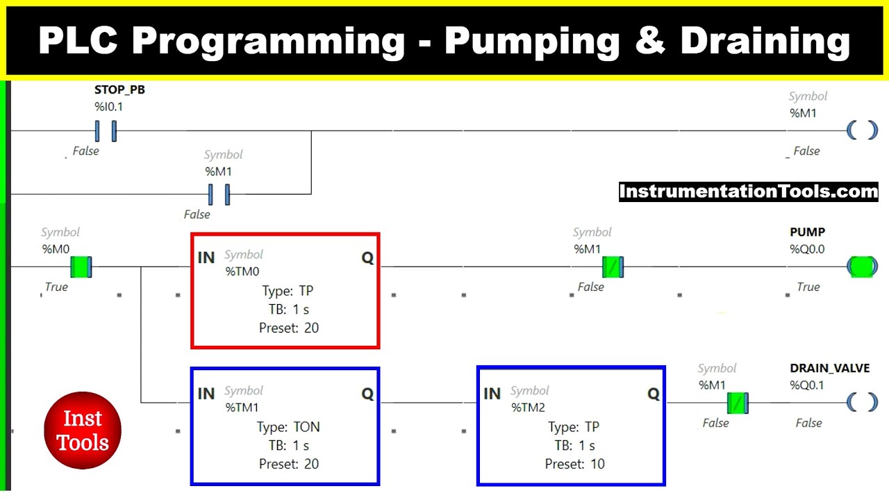

We are using two Push Buttons to control the Pump and Drain valve.
When the Start Push Button is pressed and released, the Pump should run for 20 seconds to fill the tank and then the Drain Valve should Open for 10 seconds to drain the tank.
When the Stop Push Button is pressed and released, then the system will stop immediately.

We have used Normally Open Contacts for Start Push Button(I0.0), Stop Push Button (I0.1), and Memory Bits.
We have used Normally Closed Contacts for Memory Bit 2 (M1).
In Rung 0:
  1. Normally Open Contact is used for the Start Push Button (I0.0) to Turn ON Memory Bit 1 (M0).
  2. Memory Bit 1 (M0) is latched so that when the Start Push Button (I0.0) turns OFF, Memory Bit 1 (M0) still remains ON.
 In Rung 1:
  1. Normally Open Contact is used for the Stop Push Button (I0.1) to Turn ON Memory Bit 2 (M1).
  2. Memory Bit 2 (M1) is latched so that when the Stop Push Button (I0.1) turns OFF, Memory Bit 2 (M1) still remains ON.
In Rung 2:
  1. Normally Open Contact is used for Memory Bit 1 (M0) to Turn ON the outputs Pump (Q0.0) and Drain Valve(Q0.1).
  2. Timer TP is used to Turn ON the output Pump (Q0.0) for a limited time.
  3. Timer TON is used to delay the turning ON time of the output Drain Valve (Q0.1) for some time.
  4. Timer TP is used to Turn ON the output Drain Valve (Q0.1) for a limited time.
  5. Normally Closed Contacts are used for Memory Bit 2 (M1) to turn OFF the output Pump (Q0.0) and Drain Valve (Q0.1).
When the Start Push Button (I0.0) is pressed and released,  Memory Bit 1 (M0) turns ON. Memory Bit 1 (M0) is latched so that when the Start Button (I0.0) is released, Memory Bit 1 (M0) still remains ON.
fill the tank plc program
When Memory Bit 1 (M0) turns ON in Rung0, Normally Open Contact used for Memory Bit 1 (M0) will be in True state and pass the signal through it and the output Pump (Q0.0) turns ON but for a limited time as Timer Function Block type TP is used to Turn ON the output Pump (Q0.0) for a limited time and the time set to 20 seconds.
PLC system to drain water tank
In a false state, Normally Closed Contact used for Memory Bit 2 (M1) passes the signal to turn ON the output Pump (Q0.0). So after 20 seconds, the output Pump (Q0.0) will turn OFF.
Also, when Memory Bit 1 (M0) turns ON, the output Drain Valve (Q0.1) will turn ON after 20 seconds (i.e immediately when the output Pump (Q0.0) turns OFF) as Timer Function Block TON is used to delay the turning ON time of the output Drain Valve (Q0.1).
Automatic Pumping and Draining
The time is set to 20 seconds.  In a false state, Normally Closed Contact used for Memory Bit 2 (M1) passes the signal to turn ON the output Drain Valve (Q0.1).
So after 20 seconds, the output Drain Valve (Q0.1) will turn ON but for a limited time as Timer Function Block type TP is used to turn ON the output Drain Valve (Q0.1) for a limited time. The time is set to 10 seconds. So after 10 seconds, the output Drain Valve (Q0.1) will turn OFF.
When the Stop Push Button (I0.1) is pressed and released,  Memory Bit 2 (M1) turns ON. Memory Bit 2 (M1) is latched so that when the Stop Push Button (I0.1) is released, Memory Bit 2 (M1) still remains ON.
Drain valve ladder logic
When Memory Bit 2 (M1) turns ON in Rung1, Normally Closed Contacts used for Memory Bit 2 (M1) in Rung2 will be in a True state and will not allow the signal to pass through it and the outputs Pump (Q0.0), and Drain Valve (Q0.1) will turn OFF immediately.
