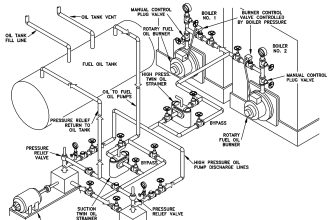

The start-up control for the boilers is enabled via a master thermostat. PLC control is to be used to ensure that 4 gas boilers do not start up simultaneously in the system.
PLC Ladder Logic for Start-up Control of BoilersSolutionList of Inputs/OutputsLadder diagram for start-up control for boilersProgram Description
Write PLC program for this application using ladder diagram language.
Programmable Logic Controller Boiler Logic
Solution
Each of the four boilers has two power settings. Each power setting is assigned to PLC.
The master thermostat is connected to PLC input. The thermostat is used to set the temperature at which the boiler is to be switched on and off. Say, If the temperature falls below 75°C, the first power setting of boiler 1 is activated for heating.
Five minutes later, power setting 2 of boiler 1 is activated. Provided that the final temperature has not been reached, a further power setting is enabled for reheating at intervals of 5 minutes.
When the final temperature of 85°C is reached, the boilers are switched off in sequence. Starting with power setting 1 and 2 of boiler 1, then after 5 minutes boiler 2, etc.
When the temperature falls, the boilers are activated again, starting with power setting 1.
