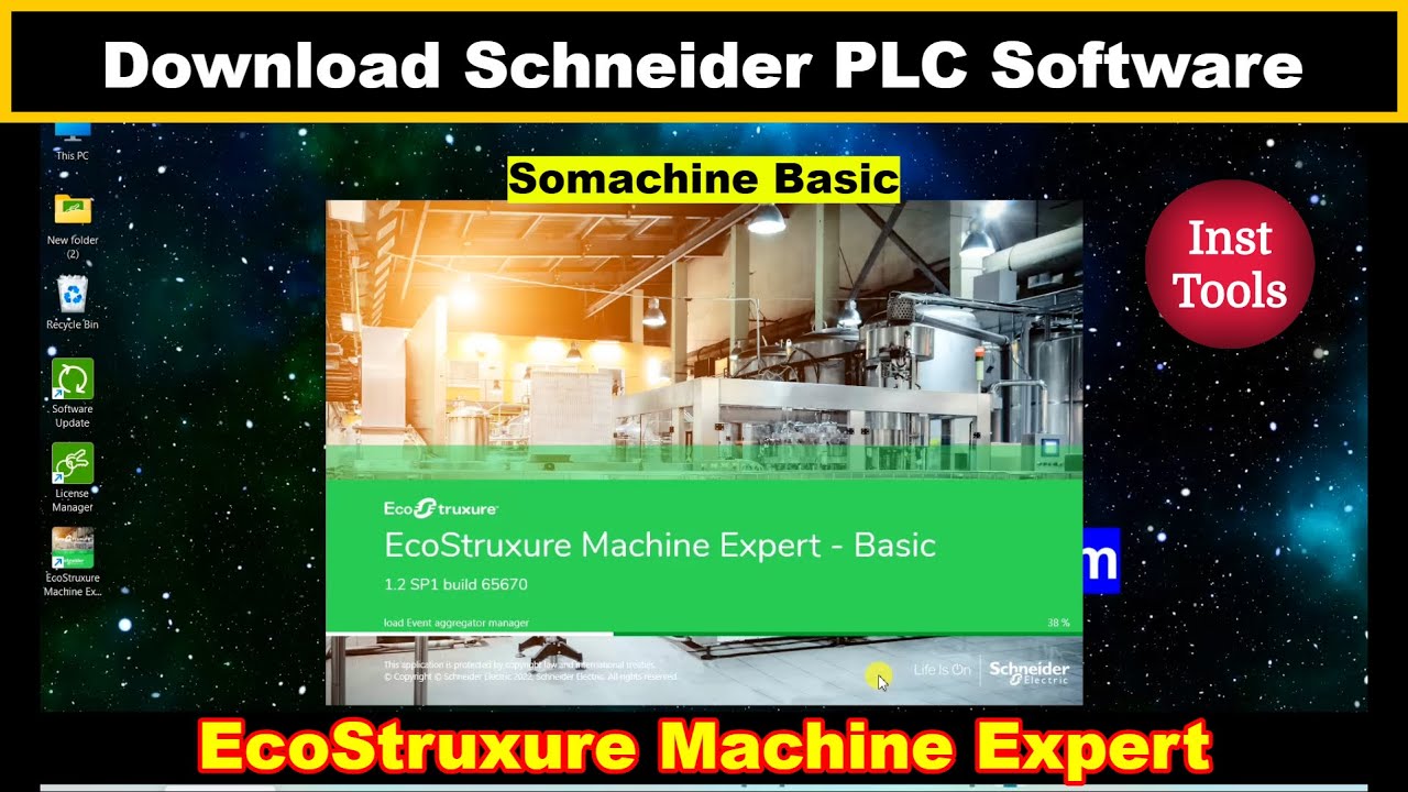

  • For this application, we used Ecostruxure Machine Expert Basic v1.2 software for programming.
