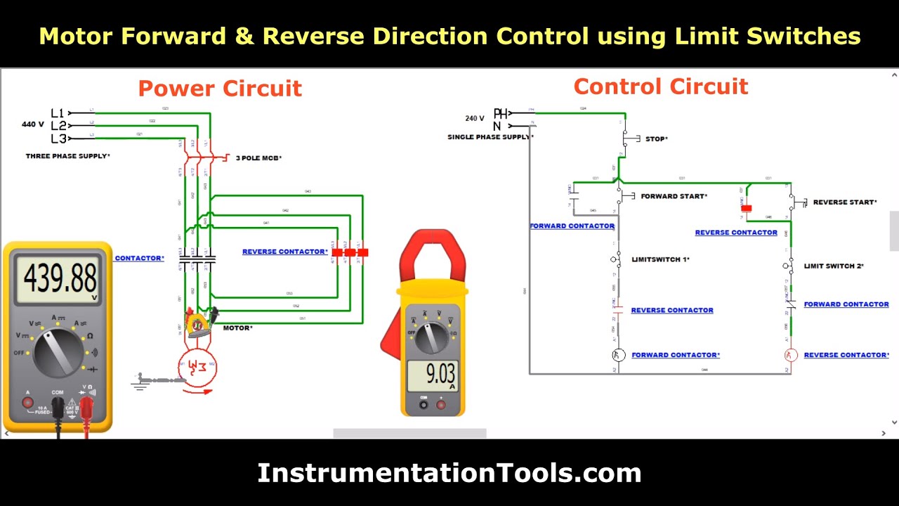

Generally, this connection is mainly used on conveyor systems in industries. Whenever the start button is pressed the motor will start rotating either Forward or Reverse depending on the input, after the signal from Limit switches were received motor stops rotating.
The main notify point in this connection is the interlock system i.e., When the motor is rotating in Forward direction then you cannot make the motor rotate in a Reverse direction unless you Stop the motor before changing its direction and vice versa.

The main components used in the power circuit are 3 Pole MCB and two contactors for forward & Reverse control of the motor.
MCB protects the motor from overload and uneven fluctuations. Contactors are used to make and break the contact to the load (motor).
An important note in this connection is any of the two phases were interchanged for the opposite directions of rotation in the motor.

 The motor in the Power circuit is controlled by components in the control circuit.
The main components in the control circuit were Start & Stop Pushbutton, Contactor coils, and Limit switches.
Limit switches were used to sense the end position & Contactor coils were used for energizing the contactor in the power circuit.

Three-phase supply of 440V is given to the power circuit for controlling the motor. The given supply passes through 3 pole MCB.
MCB, the electromechanical device actuated manually for giving the supply to the contactor and Load.
motor forward and reverse circuit
For the control circuit, a voltage of 240 V was given for controlling the load through Contactor. Then Forward Start button is pressed.
The control supply goes to the NC (Normal Close) contacts of Limit Switch 1 and Reverse Contactor, which makes the forward contactor to energize.
motor forward reverse control circuit diagram
By the energization of the Forward contactor coil in the control circuit, the Forward contactor in the power circuit got actuated which makes the motor run in a forward (clockwise) direction.
Forward reverse motor control wiring with limit switches
As soon as the Limit Switch 1 got the signal, it states changes from NC (Normally Close) to NO (Normally Open) which will de-energize the Forward Contactor coil.
Two Direction Motor Control Circuit
The forward Contactor coil in the control circuit was de-energized in the control circuit so the Forward contactor was deactivated.
So the power to the motor was disconnected. Now motor was stopped rotating.
Motor Controller Forward Reverse
Since Forward and Reverse control was used mostly in conveyors after reaching the limit it should be reversed.
So, for Reverse control the Reverse Start button is pressed for that Reverse Contactor gets energized.
3 phase motor reversing with limit switches
Here, the Reverse contactor coil gets energized in the control circuit which makes the Reverse contactor actuate in the power circuit.
By the Reverse contactor, the power was supplied to the motor, now the motor starts to rotate in a reverse (Anti-clockwise) direction
direction control of induction motor using limit switches
In this reverse control also after getting the signal from Limit Switch 2, the Reverse contactor gets de-energized.
Power & Control Circuit for Forward and Reverse Motor
So, the de-energize of the reverse contactor coil in the control circuit makes the reverse contactor deactivate in the power circuit.
So the power to the motor was stopped and the motor stops rotating.
Reverse Forward Starter Control Wiring
Thus, the process continues. After reaching the Limit Forward Start is pressed and Motor starts rotating in Forward direction. This loop continues until the stop button is pressed.
