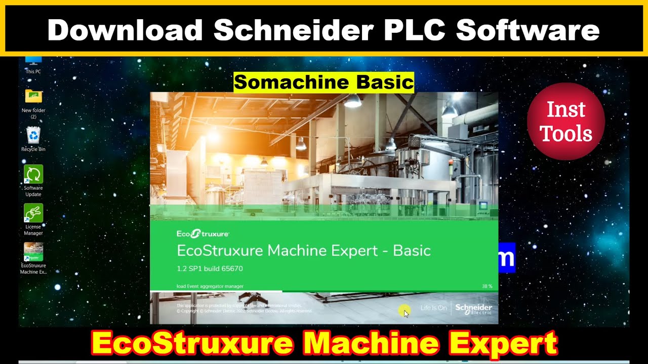

In this example, we used EcoStruxure Machine Expert Basic v1.2 software for programming.
