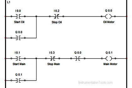

Identify the problem(s) in this PLC program, and modify it so that it will work as it should.
Last updated: March 4, 2021 11:06 am
PLC Tutorials Practical Questions
2 Min Read
A PLC has been programming to control the starting and stopping of a three-phase electric motor.
The program is supposed to require that the operator press and hold the “Start” pushbutton for at least three seconds before the motor starts and runs.
Shown here is a partial wiring diagram and offline PLC program display for the system:
PLC Block Diagram
Answer :
The way it’s programmed right now, the “Start” pushbutton does not need to be held for three seconds – just pressing it momentarily is enough to start the motor.
The motor, however, does delay for three seconds before starting.
In other words, there is a three-second time delay in effect, but it’s not requiring the “Start” switch be continuously pressed for that long.
All the time delay is doing is delaying the start-up of the motor after the “Start” switch has been momentarily pressed.
Here is a functional solution:
PLC Program three-phase motor

  • Rajachockalingam says:
    August 13, 2020 at 4:32 pm
    Also stop PB and OLR should be taken NC contact
