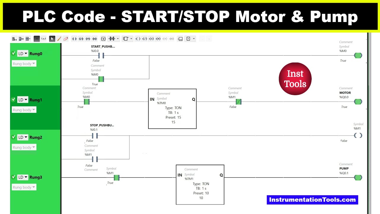

Problem Statement
We are using two Push Buttons to control a Motor and Pump.
When the Start Push Button is pressed and released, the Motor will be ON after 15 seconds.
When the Stop Push Button is pressed and released, the Motor will stop immediately and the Pump will Turn ON after 10 seconds.

Start Push Button: I0.0
Stop Push Button: I0.1
Outputs
Digital Outputs
Motor: Q0.0
Pump: Q0.1

Here we used Normally Open Contact for the Start Push Button, Stop Push Button, and Memory Bits.
Normally Closed Contact is used for Memory Bit 2 in Rung1.
Two Timer Function Block Type TON is used for the Motor and Pump.
In Rung 0:
  • Normally Open Contact is used for the Start Push Button to Turn ON Memory Bit 1.
  • Latching is used for Memory Bit 1 so that when the Start Push Button is released, Memory Bit 1 still remains ON.
In Rung 1:
  • Normally Open Contact is used for Memory Bit 1 to Turn ON Motor.
  • Normally Closed Contact is used for Memory Bit 2 to Turn OFF Motor.
  • Timer Function Block type TON is used for the Motor to delay the Turning ON time.
In Rung 2:
  • Normally Open Contact is used for Stop Push Button to Turn ON Memory Bit 2.
  • Latching is used for Memory Bit 2 so that when the Stop Push Button is released, Memory Bit 2 still remains ON.
In Rung 3:
  • Normally Open Contact is used for Memory Bit 2 to Turn ON Pump.
  • Timer Function Block type TON is used for the Pump to delay the Turning ON time.
When the Start Push Button is pressed and released, Memory Bit 1 Turns ON in Rung0 and Rung1. when Memory Bit 1 Turns ON in Rung1, the Timer starts in Timer Function Block type TON which is set to 15 seconds and then, it delays 15 seconds to Turn ON the Motor. In a false state, Normally Closed Contact used for Memory Bit 2 also Passes the signal and the Motor will Turn ON after 15 seconds.
When the Stop Push Button is pressed and released, Memory Bit 2 will Turn ON in Rung1, Rung2, and Rung3 as Normally Open Contact is used for the Stop Push Button that allows the signal to pass and Turn ON Memory Bit 2.
When Memory Bit 2 Turns ON, the Motor will Turn OFF immediately because Normally Closed Contact used for Memory Bit 2 in Rungs1 will be in a True state and will not pass the signal to the Motor.
As Memory Bit 2 turns ON in Rung3,  Timer starts in Timer Function Block type TON which is set to 10 seconds and then, it delays 10 seconds to Turn ON the Pump and the Pump will Turn ON after 15 seconds.
