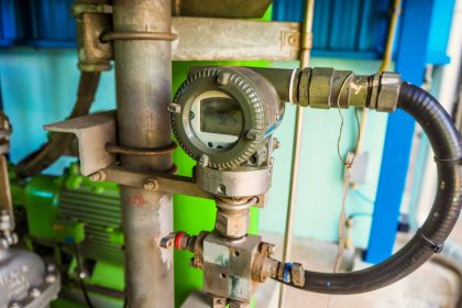

Function of a Pressure transmitter
On the other hand, transmitters measures process pressure value into equivalent current generally in the range 4-20 mA.
In general, transmitters are preferred when sending a signal over hundreds of meters. These devices are exclusively for measuring process parameters and communicating the output electronically or visually in industries.

The temperature transmitter sends the output in a 4-20 mA signal. A current signal is more resistant to interference and noise than a voltage signal.
In case of transmitter signals – On-board electronics capable of operating with maximum current usage of less than 4 mA.

A smart Transmitter sends an output 4 to 20 mA signal with an additional digital superimposed signal (whenever required) which allows a user to collect more information and other device variables besides process variables.
Transmitter has additional electronic circuitry that linearizes, compensates, and amplifies the signal from a sensor or transducer. Different signal types are typically voltage signals, milli-amp, resistance, or digital. The instrument can transmit the signal to a remote receiver.
Transmitters can be equipped with a local display unit.
