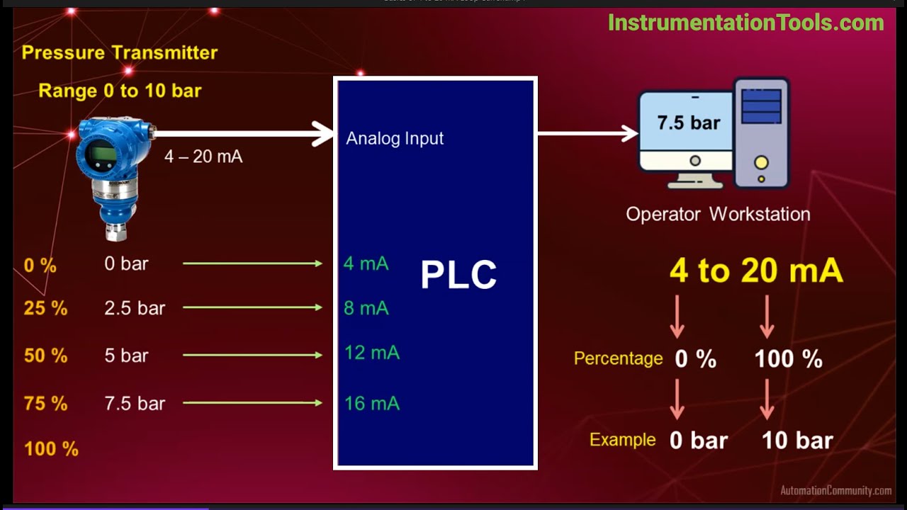

Transmitters are available with a wide variety of signal outputs. The 4-20mA analogue signal is by far the most commonly used in industrial applications.

Basics of 4 to 20 mA
Watch the below video to learn the 4-20 mA basics, history, advantages, and disadvantages.
