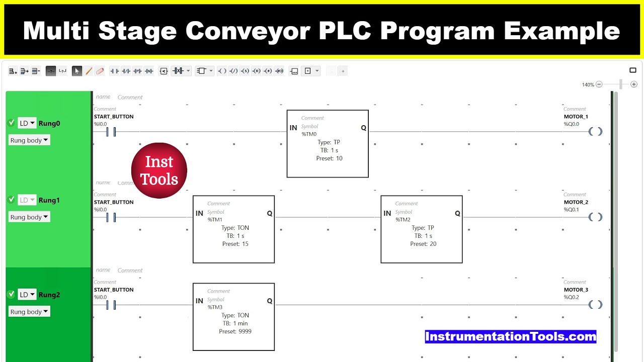

Problem Statement:
We are using one toggle switch to control 3 Motors.
When the Start Button is ON,
The First Stage Motor runs for 10 seconds, then stops.
After a 5-second delay, the Second Stage Motor runs for 20 seconds and then the Third Stage Motor will run for 15 seconds.

Inputs and Outputs
Digital Inputs:
Start Button: I0.0
Digital Outputs:
Motor 1: Q0.0
Motor 2: Q0.1
Motor 3: Q0.2

Program Description
We have used Normally Open Contact for the Start Button(I0.0).
In Rung 0:
  1. Normally Open Contact is used for the Start Button (I0.0) to Turn ON the output  Motor 1 (Q0.0).
  2. TP timer is used to Turn ON the output Motor 1 (Q0.0) for a limited time.
In Rung 1:
  1. Normally Open Contact is used for the Start Button (I0.0) to Turn ON the output Motor 2 (Q0.1).
  2. TON timer is used to delay the turning ON time of the output Motor 2 (Q0.1) for some time.
  3. TP timer is used to Turn ON the output Motor 2(Q0.1) for a limited time.
In Rung 2:
  1. Normally Open Contact is used for the Start Button (I0.0) to Turn ON the output Motor 3 (Q0.2).
  2. TON timer is used to delay the turning ON time of the output Motor 3 (Q0.2) for some time.
  3. TP timer is used to Turn ON the output Motor 3 (Q0.2) for a limited time.
Simulated Logic
Now we will simulate our program and see the test cases.
Rung 0:
When the Start Button (I0.0) is turned ON, the signal will flow through the Start Button as Normally Open Contact is used for the Start Button (I0.0).
PLC Examples on Motors for Beginners
The output Motor 1 (Q0.0) turns ON for 10 seconds because Timer Function Block type TP is used to turn ON the output Motor 1 (Q0.0) for a limited time and the time is set to 10 seconds. After 10 seconds, the output Motor 1 (Q0.0) will turn OFF.
Rung 1:
When the Start Button is turned ON, Motor2 (Q0.1) will turn ON after 15 seconds ( i.e after 5 seconds when Motor 1 gets turned OFF) because Timer Function Block type TON is used to delay the turning ON time of the output Motor 2 (Q0.1) and the time is set to 15 seconds.
Example on Ladder Motor
The output Motor 2 (Q0.1) will remain ON only for 20 seconds as we have used Timer Function Block type TP to turn ON the output Motor 2 (Q0.1) only for a limited time and the time is set to 20 seconds. So after 20 seconds, the output Motor 2 (Q0.1) will turn OFF.
Rung 2:
When the Start Button is turned ON, Motor 3 (Q0.2) will turn ON after 35 seconds ( i.e immediately when Motor 2 gets turned OFF) because Timer Function Block type TON is used to delay the turning ON time of the output Motor 3 (Q0.2) and the time is set to 35 seconds.
Motor Control With Basic PLC
The output Motor 3 (Q0.2) will remain ON only for 15 seconds as we have used Timer Function Block type TP to turn ON the output Motor 3 (Q0.2) only for a limited time and the time is set to 15 seconds. So after 15 seconds, the output Motor 3 (Q0.2) will turn OFF.
