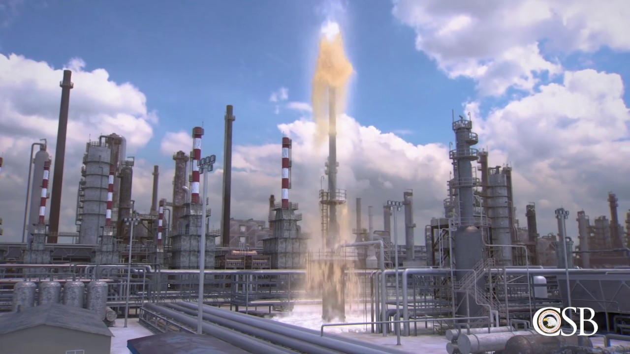

An hour later, the day shift supervisor reached the control room. He did not receive any brief status of the unit start-up activity. The board operator resumed the unit start-up and started feeding the raffinate into the splitter tower. The control valve which controlled the level of the splitter tower was left closed which resulted in more level build-up in the splitter tower. To increase the temperature in the splitter tower, the associated burners were lit.
After a few hours, due to some medical emergency, the day shift supervisor left the site and now only the board operator was present to look after the start-up and other ongoing jobs. The level was still increasing in the splitter and went above 95 feet. The level indicator still showed 9 feet. An alarm was generated which indicated high pressure inside the splitter.
To control this high pressure, the valve to blow down the drum was opened and also, the furnace was turned off. The valve to the storage tanks from the splitter was also opened. The flow to storage tanks was routed through the heat exchanger which exchanged heat with feed to the splitter tower. This increased the temperature of the feed to the splitter to 140 degrees Fahrenheit.
Due to this increased temperature, the liquid started boiling and started coming out of the vapour lines from the top. The high pressure also opened the relief valves and passed this liquid to the blowdown drum. The blowdown drum also got filled fully and began to spill the liquid into the process sewer.
The high-level alarm of the blowdown drum also did not work. As a result, the hot flammable liquid spilled like spray and formed a huge vapour cloud in 90 seconds only which covered the trailers and a standing truck that already had its engine in running condition.
This truck ignited the vapour cloud which led to heavy destruction to nearby areas and fires. Unfortunately, the trailer was also occupied by contractors who have returned to the trailers for meetings. This led to the death of 15 workers and 180 of them got injured.
