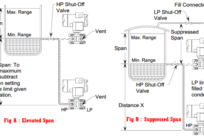

What is Zero Suppression ?
In some cases, the level transmitter has to be mounted X meters below the base of an open tank as shown in below figure.
Zero Suppression in level Measurement
The liquid in the high pressure impulse line exerts a constant pressure (P = S . X) on the high pressure side.
That is, the pressure on the high pressure side of the DP Transmitter is always higher than the actual pressure exerted by the liquid column in the tank by (SG . X) – so the reading will be in error high.
This constant pressure would cause an output signal that is higher than 4 mA when the tank is empty and above 20 mA when it is full.
When the liquid level is at H meters, pressure on the high pressure side of the transmitter will be:
Phigh = S·H + S.X + Patm
Plow= Patm
ΔP = Phigh – Plow = S . H + S . X
The transmitter has to be negatively biased by a value of S.X so that the output of the transmitter is proportional to the tank level (S . H) only.
The above procedure is called Zero Suppression and it can be done during calibration of the transmitter.
What is Zero Elevation ?
When a wet leg installation is used,the low pressure side of the level transmitter will always experience a higher hydrostatic pressure than the high pressure side.
This is due to the fact that the height of the wet leg (X) is always just greater than the maximum height of the liquid column (H) inside the tank.
Zero Elevation in level measurement
When the liquid level is at H meters, we have:
Phigh =Pgas + S . H
Plow =Pgas + S . X
ΔP = Phigh – Plow = S . H – S . X = -S(X . H)
The differential pressure ΔP sensed by the transmitter is always a negative value (i.e. the low pressure side has a higher pressure than high pressure side).
To properly calibrate the transmitter, a positive bias (S . X) is needed to elevate the transmitter output.
This positive biasing technique is called zero elevation.
