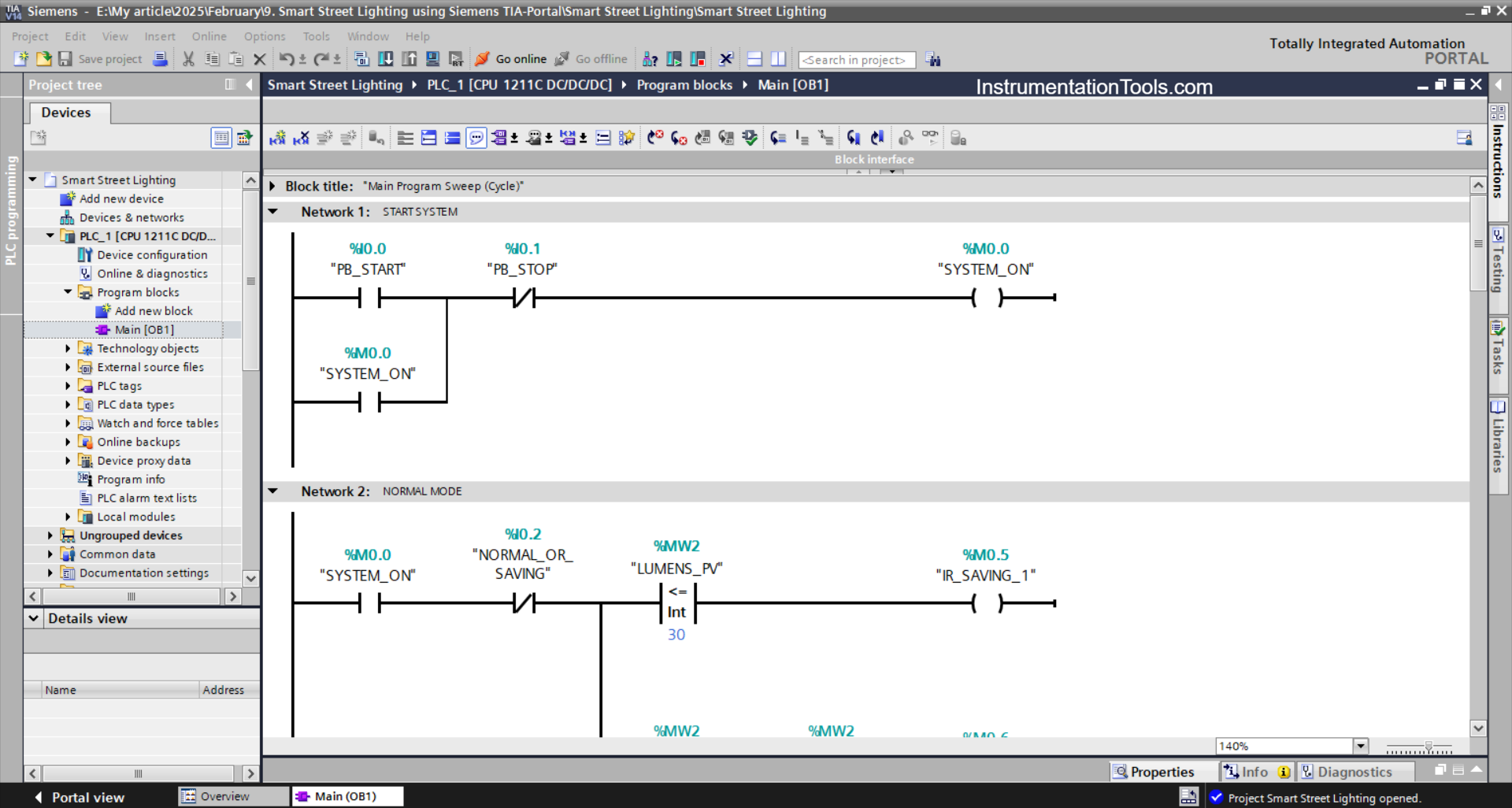

NETWORK 1 (START SYSTEM)
In this network, the memory bit SYSTEM_ON (M0.0) will be in the HIGH state when the PB_START (I0.0) button is Pressed. Even though the PB_START (I0.0) button has been Released, the memory bit SYSTEM_ON (M0.0) will remain in the HIGH state. Because it uses Latching.
The memory bit SYSTEM_ON (M0.0) will be in the LOW state if the PB_STOP (I0.1) button is Pressed.

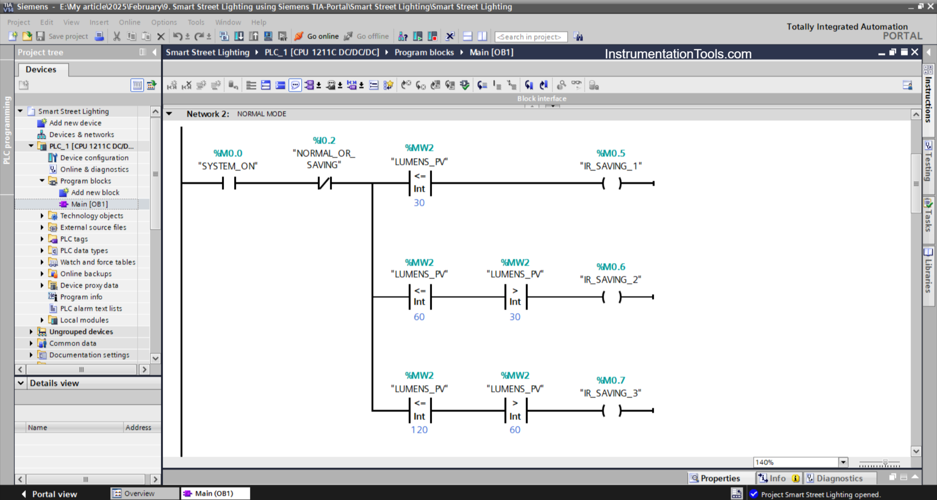

NETWORK 2 (NORMAL MODE)
In this network, when the NO contact of the memory bit SYSTEM_ON(M0.0) is in the HIGH state and the value in the word memory LUMENS_PV (MW2) is Less Than or Equal to “30”, then the memory bit IR_SAVING_1 (M0.5) will be in the HIGH state.
When the NO contact of the memory bit SYSTEM_ON (M0.0) is in the HIGH state and the value in the memory word LUMENS_PV (MW2) is Less Than or Equal to “60” and Greater Than “30”, then the memory bit IR_SAVING_2 (M0.6) will be in the HIGH state.
When the NO contact of the memory bit SYSTEM_ON (M0.0) is in the HIGH state and the value in the memory word LUMENS_PV (MW2) is Less Than or Equal to “120” and Greater Than “60”, then the memory bit IR_SAVING_3 (M0.7) will be in the HIGH state.
And if the NC contact of the selector switch NORMAL_OR_SAVING (I0.2) is in the HIGH state, then the memory bits IR_SAVING_1 (M0.5), IR_SAVING_2 (M0.6), and IR_SAVING_3 (M0.7) will be in the LOW state.

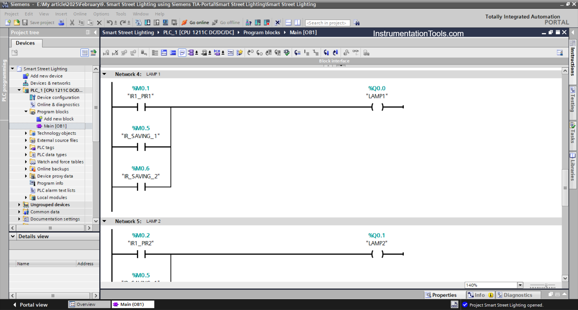

NETWORK 4 (LAMP 1)
If any of the NO contacts of the memory bits IR1_PIR1 (M0.1), IR_SAVING_1 (M0.5), or IR_SAVING_2 (M0.6) are in the HIGH state, then the LAMP1 (Q0.0) output will be ON.

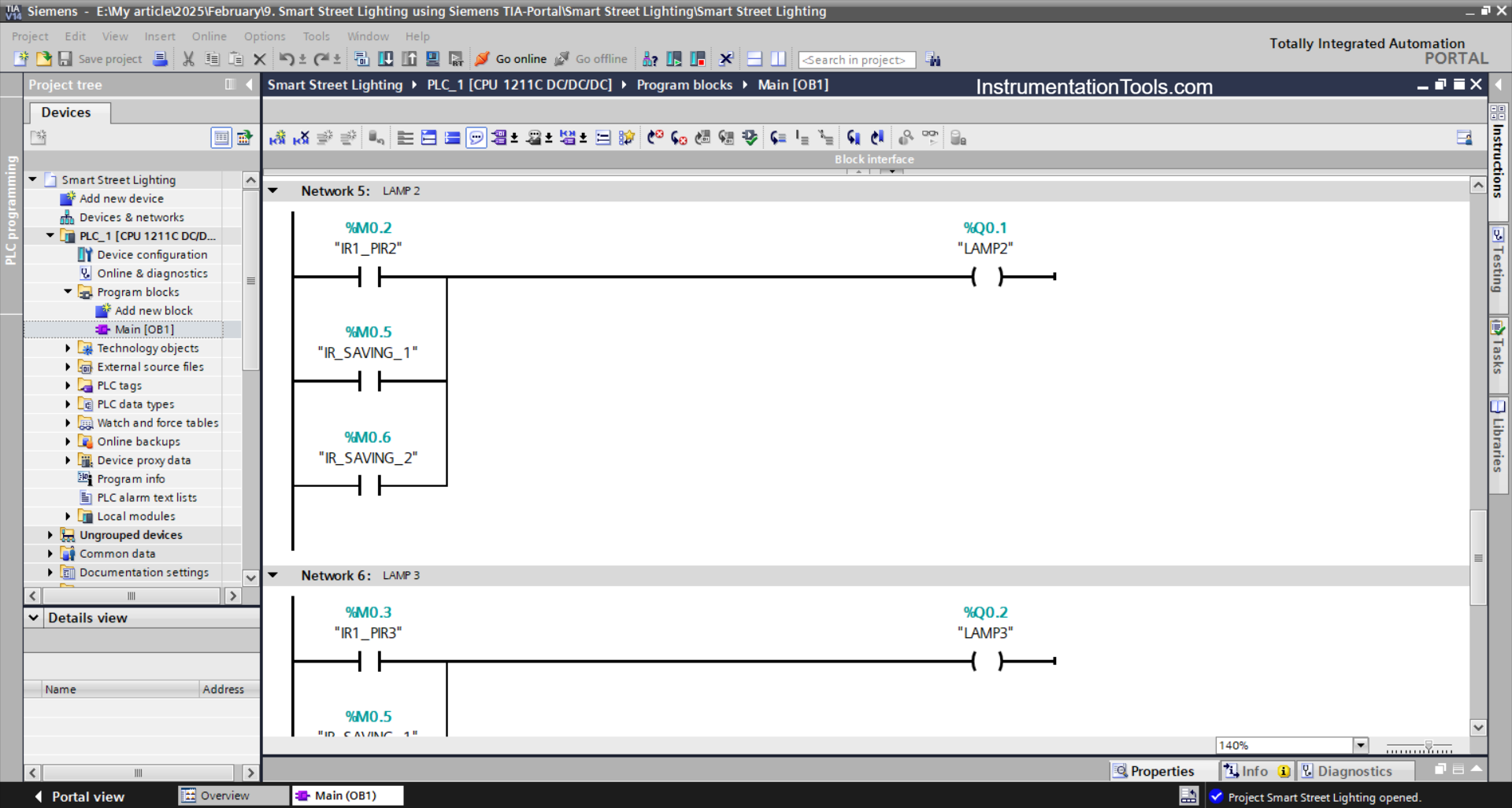

NETWORK 5 (LAMP 2)
If any of the NO contacts of the memory bits IR1_PIR2 (M0.2), IR_SAVING_1 (M0.5), or IR_SAVING_2 (M0.6) are in the HIGH state, then the LAMP2 (Q0.1) output will be ON.
NETWORK 6 (LAMP 3)
If any of the NO contacts of the memory bits IR1_PIR3 (M0.3), IR_SAVING_1 (M0.5), or IR_SAVING_3 (M0.7) are in the HIGH state, then the LAMP3 (Q0.2) output will be ON.

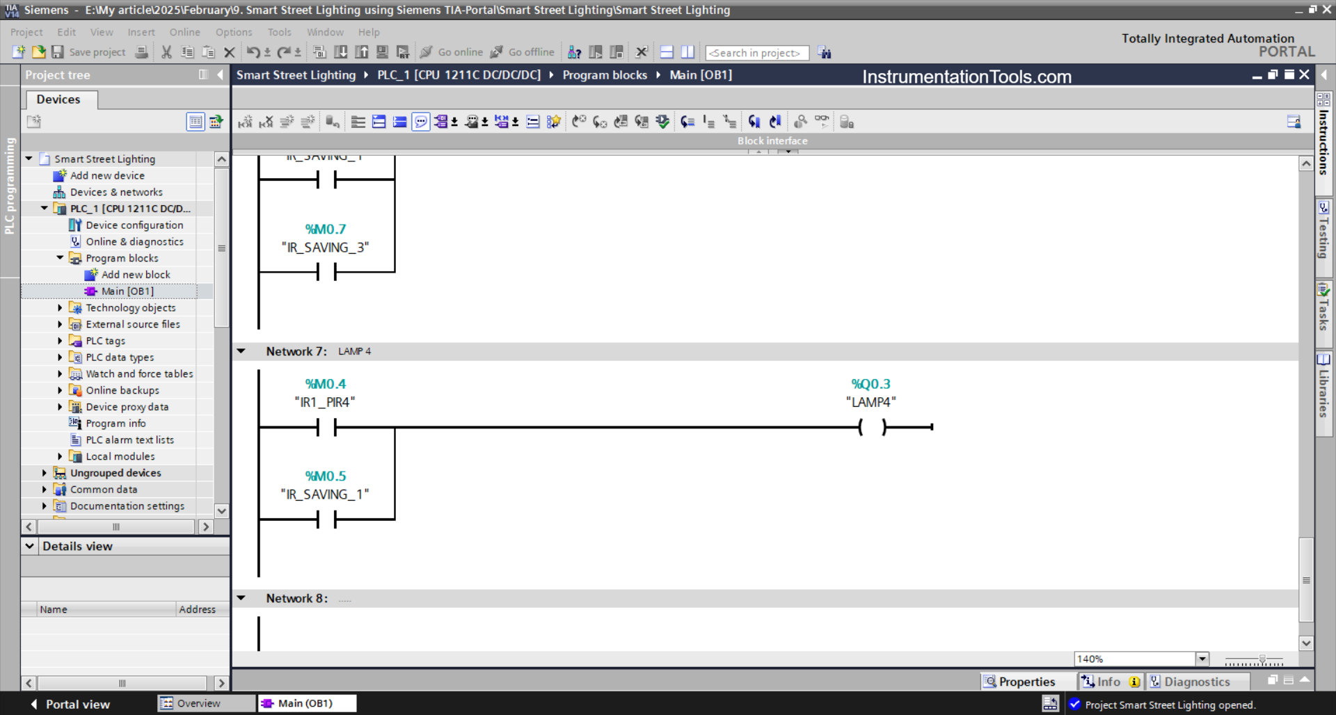

NETWORK 7 (LAMP 4)
When the NO contact of the memory bit IR1_PIR4 (M0.4) or IR_SAVING_1 (M0.5) is in the HIGH state, the output LAMP4 (Q0.3) will be ON.
