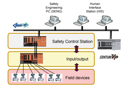

SIS is an instrumented protection layer that is designed to move the process to a safe state.
SIS system comprises of – Sensor, Logic solver & Final control element.
Safety Instrumented System Design
Image Courtesy: Siemens
Sensor
An instrument that measures process conditions. Sensor devices that measure temperature, pressure, flow, liquid level, etc.
Logic Solver
An intelligent device that performs logic functions to convert sensor input into an action command to be carried out by the final element.
Final Control Element
An equipment that performs the physical action commanded by the logic solver.  Final element devices may be control valves, motor/switchgear, etc.
