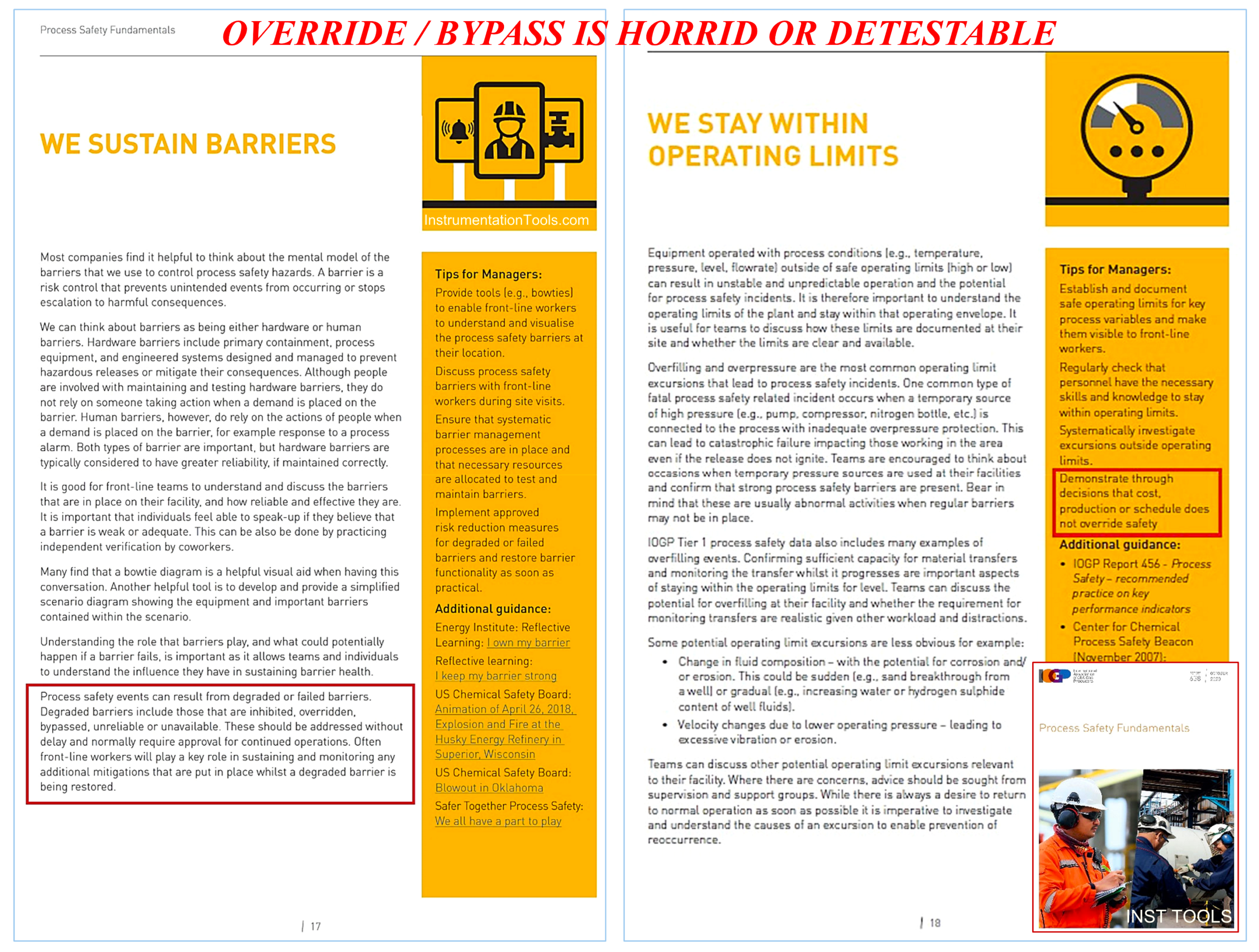

While some industrial associations inform the horrific and detestability effects of Bypass/ Override (see Figure 5), others clearly accept the Bypass Facility as one of the Fundamental Safety Aspects, and provide some more details on the use cases and required management system for this subject in their documents (Figure 6).
Figure 5: “Override/ Bypass is horrid or detestable” mentioned in IOGP-Report 38: Process Safety Fundamentals (International Association of Oil & Gas Producers- October 2020)

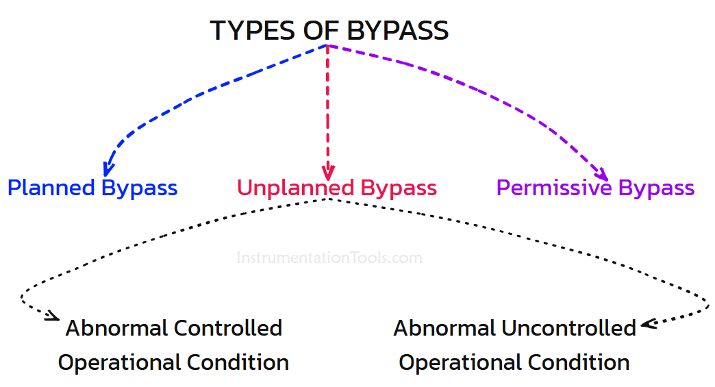

Types of Bypass
The bypasses are classified as follows.
- Planned Bypass
- Unplanned bypass (Abnormal Operational Conditions)
- Permissive bypass
1. Planned Bypass
Routine online checks or testing of the instrumented systems. Bypass risk assessment shall be carried out, and all specified risk control measures put in place before the bypass is used for tasks within this category.
2. Unplanned Bypass
The unplanned bypasses are based on abnormal operational conditions, categorized into two parts
a. Abnormal Controlled Operational Condition
An ‘abnormal controlled operational condition’ is a developing process upset that has the potential to lead to a trip. If the situation has developed from a ‘known’ cause and has a well-practiced method of quickly mitigating the risk and re-stabilizing the operation, the ‘controlled’ use of bypass may be used in such circumstances. The appropriate approval and authorization are required when its use is clearly identified within a recognized practice and or procedure.
b. Abnormal Uncontrolled Operational Condition
An ‘abnormal uncontrolled operational condition’ is a process upset where the cause is unknown and therefore no method of address is immediately available or known, and a process of investigation and diagnosis is required to identify the cause. Bypass shall never be used for “uncontrolled abnormal operational condition.”
3. Permissive bypass
When the trip function of a safety instrumented system is in an activated state and is therefore preventing the continuation of a start-up or other operational procedure, the use of bypass may be required as a ‘permissive’ to allow one or more of the safety instrumented system input parameters to reach the values required to enable its ‘reset’.
Once the instrumented system parameters have all reached the ‘stable’ values required to enable its ‘reset’, the permissive becomes the bypass again and therefore must be immediately removed to enable the instrumented system protection.]]
