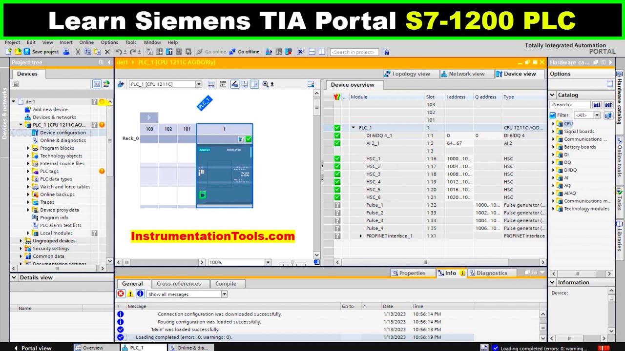

How to configure PLC with the given example?
Below we will discuss the basic PLC project creation with the required hardware.
Learn Siemens TIA Portal S7-1200 PLC Course - Intro | Download | Installation
The hardware configuration of the CPU:
Selecting the CPU:
When you start a new project in TIA Portal, you should configure a new device and add it to your project. See picture 1.
hardware configuration of a PLC
Picture 1. Configure a device for your project
As you can see from the previous picture, the TIA portal already shows you that the first step should be configuring a new device.
In the previous article, we discussed how to choose the PLC that fits your process, so we will not mention that here again, for our project as it is a simple project we will choose the CPU 1214C AC/DC/RLY. See picture 2.
Add a new controller to the PLC project
Picture 2. Add a new controller to the project
