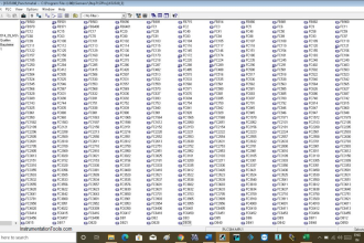

Now main thing how to take address my before post how to make allen bradley PLC address as per standard .here just see navigator menu   in navigator menu in data file all address are display here.
We take input coil so we go in input , click on input new window open select your input address .just drug and drop on element ,address tack automatically.
Allen Bradley PLC Map
Allen Bradley Programming Logic
Allen Bradley Ladder Logic
Same do in output side. Take address and drag and drop.
Allen Bradley Software
Now input side address and output side address is Ok.
