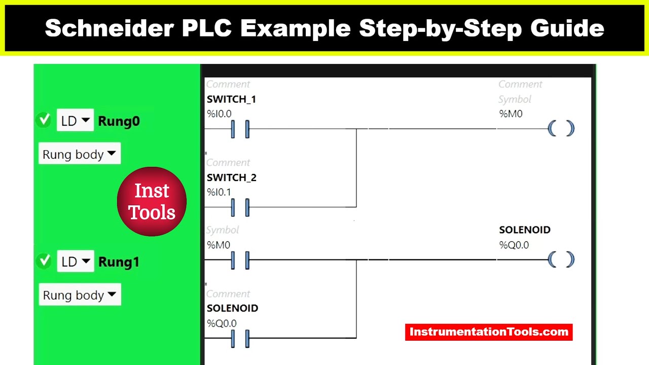

We are using two push buttons to control the Solenoid.
When Push Button 1 or Push Button 2 is pressed and then released, then Solenoid will be ON.
When Push Button 1 or Push Button 2 is pressed again and then released, then Solenoid will be OFF.

PLC Program Description
We used Schneider Electric PLC software.
In the above program, we used Normally-Open Contacts as well as Normally-Closed Contact and Memory Bits.
Normally Closed Contact is used for Memory Bit 1 in Rung 2 and Memory Bit 3 in Rung 1.
In Rung 0, 1) Push Button 1 and Push button 2 are connected in parallel, thus implementing OR Logic Gate.
Normally Open Contact is used for Push Button 1 and Push Button 2  to turn ON the Memory Bit 1.
In Rung 1:
  • Normally Open Contact is used for Memory Bit 1 and Normally Closed Contact is used for Memory Bit 3 to turn ON the Solenoid.
  • Latching is used for Solenoid so that when Memory Bit 1 turns OFF, Solenoid still remains ON.
In Rung 2:
  • Normally Closed Contact is used for Memory Bit 1 and Normally Open Contact is used for Solenoid to turn ON Memory Bit 2.
  • As Memory bit stores the data, Memory Bit 2 is used to store the data that Push Button 1 or Push Button 2 has been released.
In Rung3:
  • Normally Open Contact is used for Memory Bit 1 to turn ON Memory Bit 3.
  • Memory Bit 2  is used to store the data when Push Button 1 or Push button 2 is pressed again.
  • Memory Bit 3 i.e. latched with Memory Bit 2 is used to turn OFF the Solenoid, So that when Memory Bit 3 turns ON in Rung 3, Normally Closed Contact used for Memory Bit 3 in Rung 1 will be in a True state and Solenoid will turn OFF.
So, when Push Button 1 or Push Button 2 is pressed, signal will flow through it as Normally Open Contact is used for Push Button 1 and Push Button 2 in Rung 0, and Memory Bit 1 will Turn ON.
In Rung 1, the signal will flow through Memory Bit 1 as Normally Open Contact is used for it. In a false state, Normally Closed Contact used for Memory Bit 3 also passes the signal and the Solenoid will turn ON. When Push Button 1 or Push Button 2 is released, the Solenoid will remain ON as Latching is used for Solenoid in Rung 1.
When Push Button 1 or Push Button 2 is released, Normally Closed Contact used for Memory Bit 1 in Rung 2 will be false state and allow the signal to pass. Normally Open Contact Used for Solenoid in Rung 2 will also pass the signal as it is in True state and Memory Bit 2 will turn ON which is connected with memory Bit 1 and Solenoid in Rung 2.
When Memory Bit 2 will turn ON, it will store the data that Push Button 1 or Push Button 2 has been released. When Push Button 1 or Push Button 2 is pressed again, Memory Bit 2 in Rung 3 will turn OFF and store the data that Push Button 1 or Push Button 2 is pressed again, and Memory Bit 3 will turn ON i.e. latched with Memory Bit 2 in Rung 3.
So, When Memory Bit 3 turns ON in Rung 3, Normally Closed Contact used for Memory  Bit 3 in Rung 1 will be in True state and the Solenoid will turn OFF. When Push Button 1 or Push Button 2 is released again, the Solenoid will remain OFF as Normally Open Contact used for  Push Button 1 or Push Button 2 in Rung 0 will be in a false state and does not allow the signal to pass.
