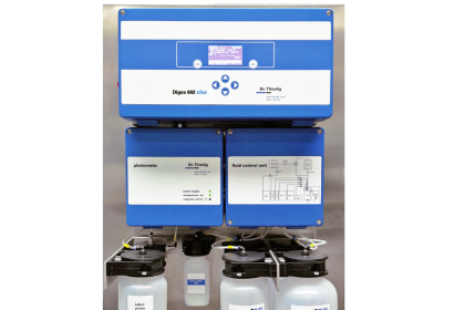

The Oil in Water Analyzer uses the UV source, photo-detector, and a sample cell to measure the fluorescence light.
Last updated: October 12, 2020 4:54 pm
Analyzers
2 Min Read
There are different technologies available to measure the oil in water like infrared, semiconductor based sensors, UV fluorescent, UV absorbance, etc. The UV fluorescent technology mostly used in the oil and gas industries.
Oil in Water AnalyzerPrincipleOperationAdvantages
Oil in Water AnalyzerOil in Water Analyzer Principle
Principle
The main principle is when a UV light source passes through the oil in water sample then the oil molecules will be excited to a higher energy level.
Then the excited molecule will again come back to its normal state (lower-energy level), during this process the molecules emits a light called as fluorescence light.
By measuring this fluorescence light, we can determine the oil in water.
Operation
A UV lamp is used to generate the ultraviolet light source which is used to excite the oil molecules. These UV source is then passed through a excitation filter to pass the selected wavelengths and blocks the remaining walelengths, as per our design.
Then the filtered UV source will be passed through a flow cell (also called as sample chamber or sample cell).
The oil molecules will absorb the UV light and the oil molecules energy level will change from lower to higher state. After some time, the molecules will again come backs from high state to low state, during this time the molecules emits a light outside and this is called as fluorescence light.
A set of photo-detectors (measured and sample) is used to measure the oil in water by measuring the generated fluorescence light.
