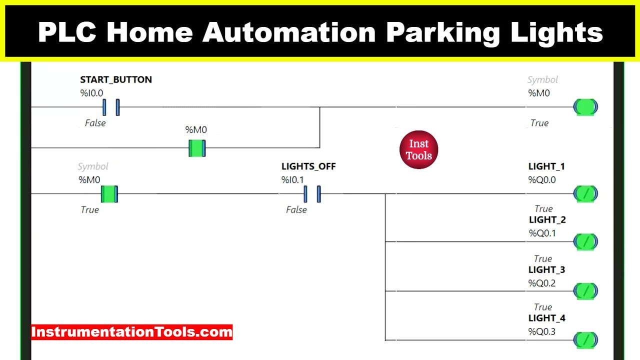

We have used Normally Open Contacts for the Start Button (I0.0, Lights OFF (I0.1), and Memory Bit (M0).
We have used Normally Closed Contacts for Exit Light (Q0.4) and Sensor (I0.2).
In Rung 0:
  1. Normally Open Contact is used for the Start Button (I0.0) to Turn ON Memory Bit (M0).
  2. Memory Bit (M0) is latched so that when the Start Button (I0.0) turns OFF, Memory Bit (M0) still remains ON.
In Rung 1:
  1. Normally Open Contacts are used for Memory Bit (M0) and Lights OFF (I0.1)  to Turn OFF the outputs Light 1 (Q0.0), Light 2 (Q0.1), Light 3 (Q0.2), Light 4 (Q0.3).
  2. Normally Open Contacts are used for Memory Bit (M0) and Lights OFF (I0.1)  to Turn ON the output Exit Light (Q0.4)
  3. Timer Function Block type TP is used to turn ON the output Exit Light (Q0.4) for a limited time.
In Rung 2:
  1. Normally Open Contacts are used for Memory Bit (M0) and Lights OFF (I0.1)  to Turn ON the output Parking Light (Q0.4).
  2. Normally Closed Contacts are used for the Exit Light (Q0.4) and Sensor (I0.2)  to Turn ON the output Parking Light (Q0.4)

Rung 0:
When the Start Button (I0.0) is pressed and released, Memory Bit (M0) turns ON and stores the data that the Start Button (I0.0) is pressed the first time as Memory bits store the data.
Program Parking Lot Control with PLC Simulator
Memory Bit (M0) is latched so that when the Start Button (I0.0) is released, Memory Bit (M0) still remains ON.
Parking Lot Automation PLC Tutorial
Rung 1:
When Memory Bit  (M0) turns ON in Rung0, Normally Open Contact used for Memory Bit  (M0) in Rung1 will be in True State and will pass the signal through it.
A PLC program for parking lights
When Light OFF Switch (I0.1) is turned ON, the outputs Light 1 (Q0.0), Light 2 (Q0.1), Light 3  (Q0.2) and Light 4 (Q0.3) will turn OFF as Negated Coils are used for the outputs Light 1 (Q0.0), Light 2 (Q0.1), Light 3  (Q0.2) and Light 4 (Q0.3).
PLC Programming for Home Automation Parking Lights
Also, when Memory Bit (M0) and Light OFF switch (I0.1) are turned ON, the output Exit Light (Q0.4) will turn ON ( immediately after Lights turn OFF in the building) but the output Exit Light (Q0.4) will turn OFF after some time as timer Function Block type TP is used to turn ON the output Exit Light (Q0.4) for a limited time.
The time is set to 15 seconds. After 15 seconds, the output Exit Light (Q0.4) will turn OFF (Exit Door Light turns OFF).
Rung 2:
home automation to control the lights based on sensor
When Memory Bit (M0) turns ON, Light OFF switch (I0.1) is turned ON (Lights turns OFF in building), Exit Light (Q0.4) turns OFF (Exit door light turns OFF) and Sensor (I0.2) gets deactivated (Car gets out of parking), the output Parking Light (Q0.5) turns ON ( Parking lot lights gets ON).
