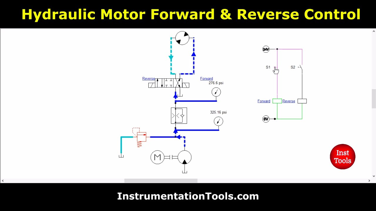

This article is about controlling hydraulic motor forward and reverse control application with flow regulation through a directional control valve with simulation. This hydraulic motor was controlled by the movement of a Directional control valve through the solenoid by activating the switches.

Hydraulic Circuit Diagram
Hydraulic Motor Forward and Reverse Control with Simulation
Hydraulic Motor Principle
A 24 V power supply was given for the circuit to control the movement of the solenoid through the actuation of switches. Two switches were used in the system. One for forward and one for reverse.
The motor is used for driving the pump for transferring the fluid to control the system and get the definite output.
Hydraulic motor clock wise and anticlockwise
The forward switch was pressed, and the solenoid/relay was actuated which made the forward movement of the motor. The fluid enters the motor through the directional control valve with the movement of forward solenoid actuation.
Initially, the directional control valve was in the center position, in that fluid would not move to the actuators. Since all the ports in the positions were blocked. Then through the operating port fluid enters the motor and some fluid is returned to the reservoir through the exhaust port.
Now the motor was rotating in the forward movement. Simultaneously, pressure relief will be operating with the predefined pressure, if the predefined pressure exceeds, the valve gets relived which makes all the components in the system safe.
 hydraulic motor was controlled by the movement of Directional control valve
If we want to make the motor rotate in a reverse direction, turn off the switch of  Forward motion and press the reverse switch which makes the motor rotate in the reverse direction.
control the direction of a hydraulic motor
Then we want to reduce the pressure or flow in the system means we can make adjustments in the flow control valve as per requirement. All the pressure flow in the system was monitored or measured through a pressure gauge.
As per the requirement, we can change the direction of the motor by switching through forward and reverse switches.
