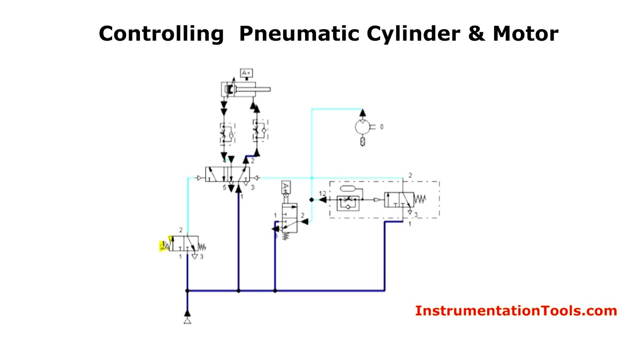

Circuit Diagram
Control of Pneumatic Cylinder and Motor
Working Principle
Compressed air of 4 – 6 bar is given to the system with the help of a compressor. Air supply entered into the system by getting into the FRL unit for removing the dust, for stable air supply, and for the friction of internal parts of the actuators.
Then the 3/2 Direction Controlled Push button is pressed manually and the air direction changes through the ports and enters into the 5/2 Direction control Pilot valve which makes the cylinder to move forward. The flow enters to the cylinder can be adjusted with the help of Flow Control as per the requirement
Once the cylinder is actuated forward, it touches the roller valve at its end position. This forward movement of the cylinder is clamping the component. Once it is clamped, it gives the signal through the roller valve for the motor. Then the motor starts to rotate. This rotation is considered as the fixing of the component (Tightening).
control of pneumatic systems
The motor will rotate only for a certain time as per the requirement.
The required time is marked in the timer depending on that it will actuate the timer and after the set time it will give the signal to the 5/2 directional pilot actuated valve which makes the cylinder to move backwards and at the same time motor will also stop its rotation. This will be considered as the de-clamp of the component.
