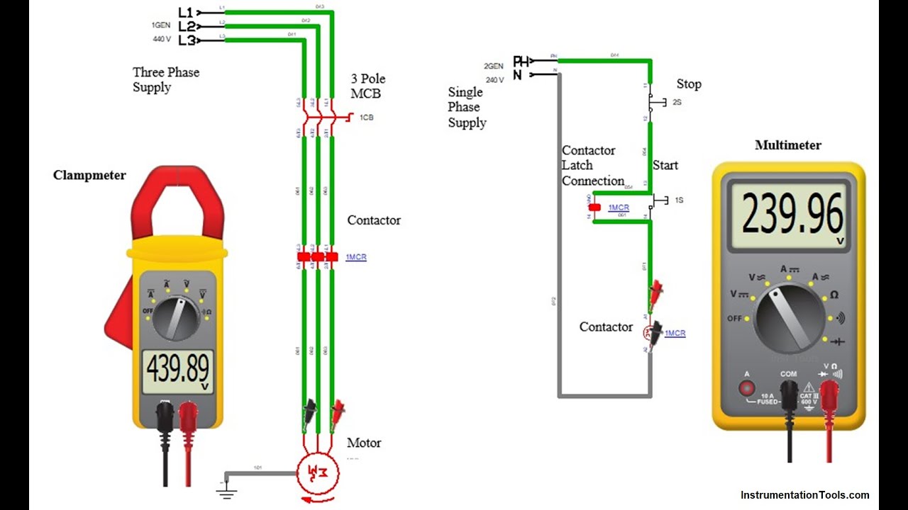

  • We can measure the parameters (Current & Voltage) in this circuit by using multimeter and clamp meter.
  • Multi-meter is used here for measuring Voltage and Clamp meter is used for measuring Voltage and Current here. Picture is given below for reference.
DOL Starter Testing
  • In control circuit we measure the voltage by placing the two probes of Multi-meter in Phase and Voltage, We got the applied voltage which were shown in display.
  • In Power Circuit, we used clamp-meter measuring Voltage and Current, Voltage is measured by placing the two probes in any two phase of supply ( for three measurement we want to place the probes in any two phase). Current is measured by the tong in the clamp meter by clipping in any one of the phase.
