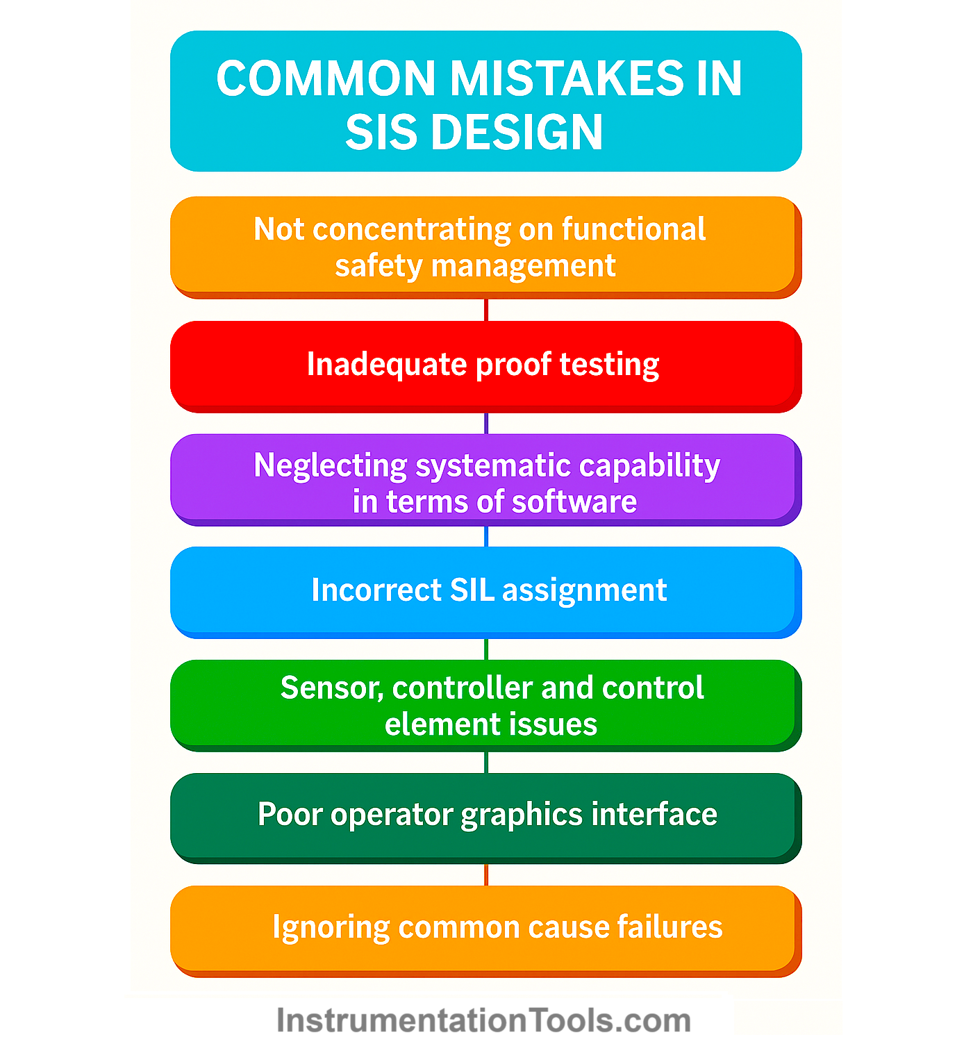

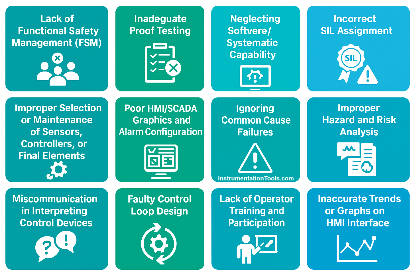

Common Cause Failures in Safety Instrumented Systems
Not concentrating on functional safety management
FSM or functional safety management is a method to document the safety process of the system. Not dealing properly in FSM means either people do not read the document, or do not update any changes in it frequently, or insufficient training and unclear responsibilities are defined for the staff. So, working without a regulated FSM procedure itself is the first place to fail the SIS, as the operator will not know what to do in case of the prevention of hazardous situations.
Inadequate proof testing
You have installed the sensors, controllers, and control elements for implementing SIS. But you are not testing their functionalities on a regular, planned basis by shutting the system down during maintenance. The device must have either failed, given false outputs, or the wire is broken. If you do not check it, then the next process running will immediately fail and cause a hazard. This can also happen if you test regularly, but use the wrong method.
Neglecting systematic capability in terms of software
Even if your hardware components are intact and tested regularly, it can also happen that the program written in the controller may have some faults. These issues may not be visible during normal conditions but can arise under abnormal or unexpected scenarios. For example, as per your logic document, you have tested the safety logic. But think like if that happened, then what? This logic may not have been implemented by the programmer. Accordingly, the configuration of SIS, wiring of the IOs, or proper logic implementation may be inadequate. This will not comply with the standard and could fail the system.
Incorrect SIL assignment
Safety integrity levels range from 1 to 4, with 1 being the lowest and 4 being the highest. According to the hazard analysis and risk plans, if you implement a lower SIL rating to a process requiring a higher SIL rating, then the system will fail. Wrong assumptions, rising costs, poor hazard analysis, and failing to read the documents properly lead to such circumstances.
Sensor, controller, and control element issues
The devices mentioned above are properly selected and found working initially, but they can be affected by the outside environment, process fluids, and contaminants. Failing to recognise them, or not calibrating them on time, or maintaining them poorly, will cause the failure to comply with SIS and hamper the system.
Poor operator graphics interface
The HMI or SCADA system is designed to show the alarms occurring and safely maintain the system. Sometimes, due to the wrong or unwanted configuration of the alarms, the operator can get confused. He will misinterpret the meaning and operate the system in the wrong way. However hard the SIS is designed, if the information you show on screen is not proper, then that itself is a complete failure.
Ignoring common cause failures
Bugs like using the same power source for the instruments, avoiding power supply redundancy, not taking backup of the controller regularly, not using diverse technologies for redundancy (like the sensor or control element will be of same technology), wrong configuration of the electrical cables and not logically separating the IOs in the program properly can lead to catastrophic results and a complete SIS failure.
Some other causes of SIS failure, as mentioned by ISA-84, are:
- Improper hazard analysis study and risk assessment methods afterwards.
- Miscommunication in reading the correct control devices.
- Improper design of control loops.
- Lack of participation from the workers in training themselves.
- Improper graphs or trends of the sensor or control element readings shown on the HMI.
