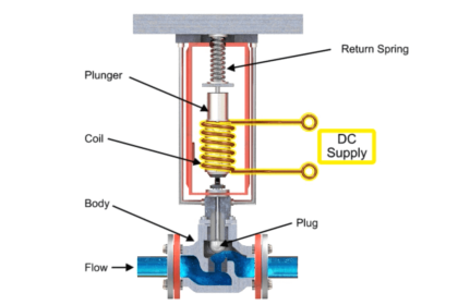

Solenoid Valve Construction Style
The three general types of solenoid valves are as follows
  1. Plunger or poppet style, the plunger is directly moved using an electromagnetic solenoid to control the air flow through the solenoid.
  2. Diaphragm type to control the air flow through the solenoid.
  3. Cylindrical spool type with ports moves to control the air flow through the solenoid.
The electrically actuated solenoid is the most commonly fitted with pneumatically operated valves.
