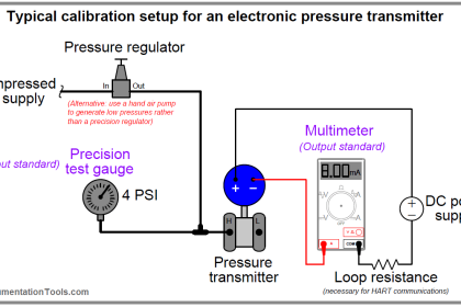

Pressure Calibration
It is used for instruments such as transmitters, test gauges, and barometers. In pressure calibration, the spectrum of hydraulic and gas pressure is measured.
